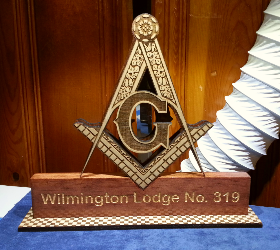

Been looking to make some centerpieces for my Masonic lodge dining room tables and finally settled on a design. Made from 1/4" birch ply and 1" pine board. It’s double sided with gold leaf paint in the lettering. Lol my lodge is loving my laser machine
Wow, that’s pretty spectacular. Nice work Ned.
Thanks @Yuusuf_Sallahuddin_Y . I’m rather pleased myself on how it well it came out
One of the biggest concerns I had with making this was the mounting of the top symbols to the base. The mounting area is recessed into the base but the mating surface is still relatively small, and especially with it being a plywood corner, I was worried about the long term strength of a glue bond. What I ended up doing was taking my dremel, with a 1/16" ball bit, and carving a series of small undercut holes in both sides of the mating surfaces. I then glued them together using some Gorilla glue, which expands while it cures, which completely locked the pieces together. The end result is a bond that would require breaking wood to get them apart.
That looks amazing brother! The checkered base is a nice touch.

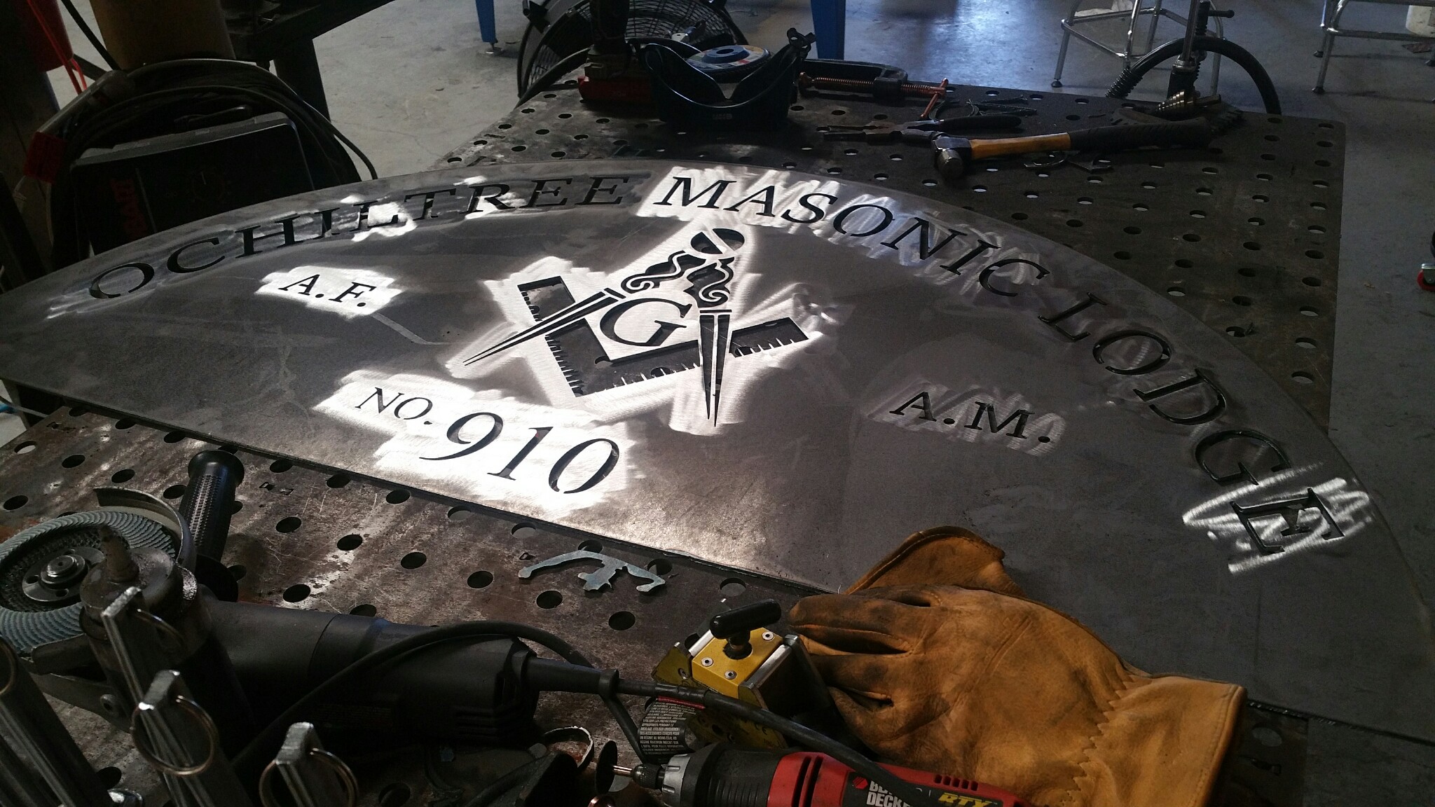

Nice, is that your work?
Yes sir, it’s to mount over our door at the lodge. Plasma art is the main thing my shop does.
