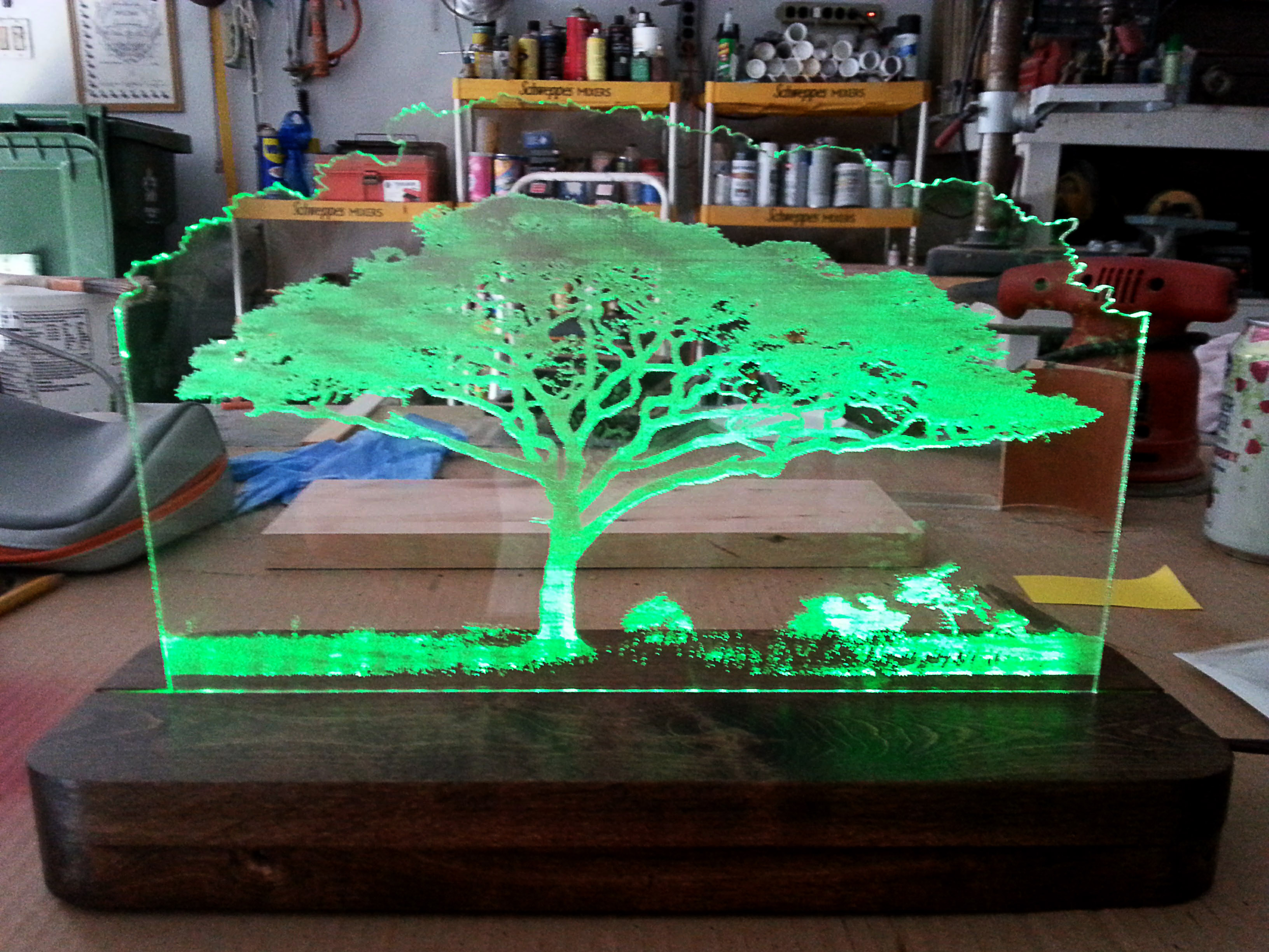

Been messing around with LEDs as of late, so I decided to incorporate a little lasing into the mix…Wife wanted a soft evening light that could be left on in the kitchen without being in your face. I decided to etch a piece of plexi and backlight it. I’ve always like the tree that stands on the savannah at the beginning of the show “Nature” so grabbed an image off the internet and manipulated it in photoshop. Anyhow, here’s the result…btw, the tree’s called an umbrella thorn.

Thanks for nice comments gents…Regarding multiple layers of plexi, you can buy RGB leds that are programmable that would eliminate a lot of headaches that would be involved in positioning different layers of materials. I did it the old fashioned way with individual LEDs and resistors, but there are LED light strips available that are extremely versatile (and relatively cheap).
Nice. Can you show placement of the LED backlighting? Thanks
Yeah, sure. If you look at the base of the tree, you will see a slot which the plexi slides into; that slot contains 30 LEDs along the length that shine upward. Looking at the base, you can the individual LEDs radiating upward, edge lighting the tree.
