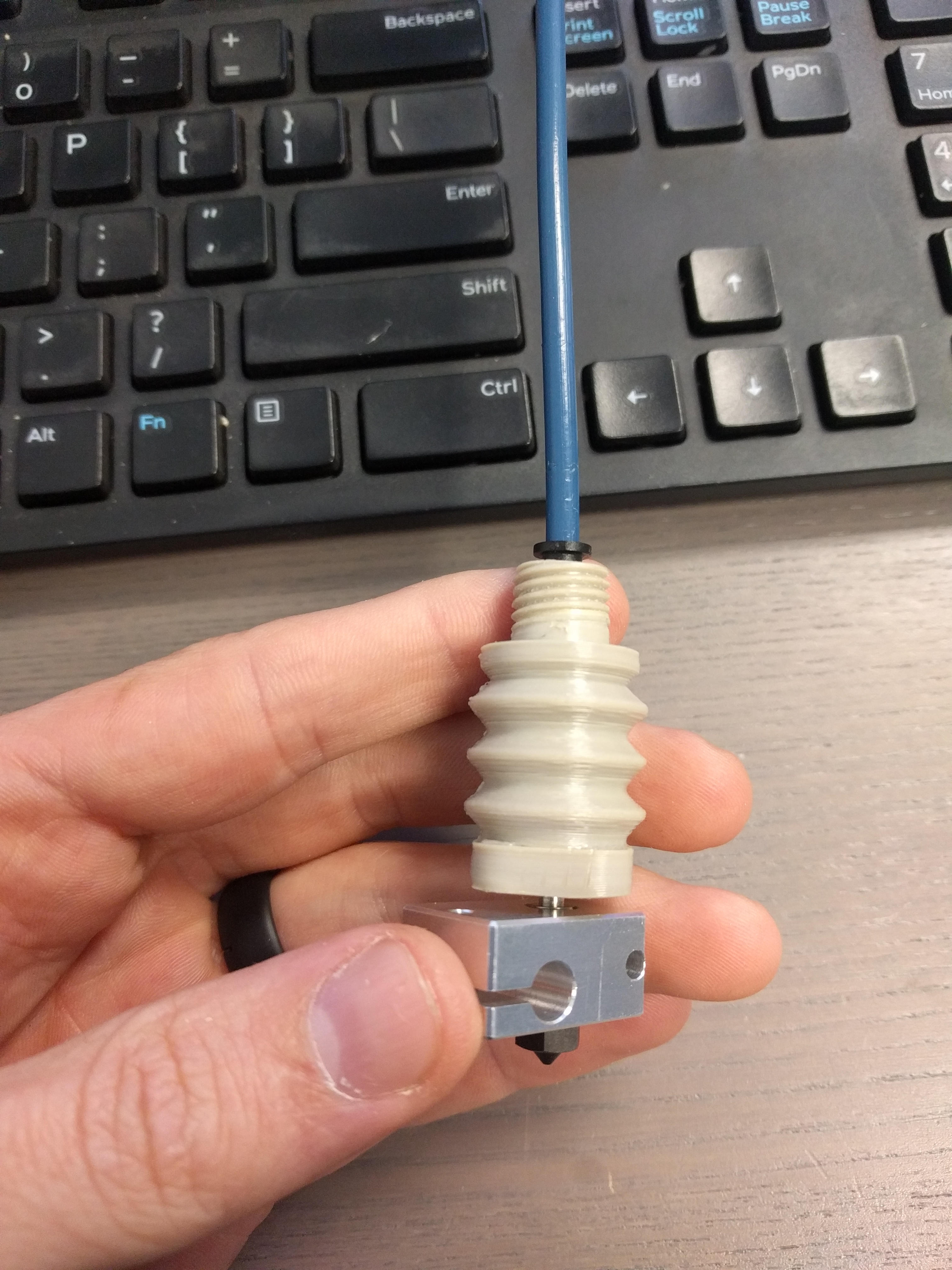

Been playing with PEEK for the past week.
Printed a PEEK heat sink (J Head clone?)
Though it won’t be replacing the aluminum one any time soon, it’s still awesome.

@Taylor_Landry1 - Wow. Who’s the supplier of PEEK? Are you using a glass-filled PTFE liner?
It’s a PEEK filament we (MatterHackers) are working with a compounder on.
Not using GF PTFE. It has a stock E3D v6 heat break in it, so PTFE is about 15mm above the bottom of the part.
I’ll be actively cooling it, and I’m only planning to print PLA with it, so the PTFE shouldn’t have any issues.

@Taylor_Landry1 print settings, chamber temp?
450c hot end, 160c bed, 90c chamber. Print speeds 40mm/s
PVP glue stick on a frosted glass plate
@Taylor_Landry1 interesting, thanks. That’s up near the glass temp of PVP so I’m surprised it’s working as an adhesive at that point.
Yes, it appears to crystallize on the bed. But it does work
Looks like it’s still in amorphous state, to get the true industrial properties of PEEK, it needs to become crystallized (according to my limited understanding of PEEK)
According to a person I spoke to, who is smarter then me, if PEEK isn’t in crystal form, it’s not really better then ABS/PETG.
@Daid_Braam it has definitely crystallized, though it needs to be annealed in order to crystallize it fully (or as much as it is able). It is a pretty awesome material.
Amorphous PEEK is translucent and looks like amber, crystalline is tan like the image. I prefer the amorphous but I’ve been told it needs to be annealed for maximum properties, including chemical resistance.
