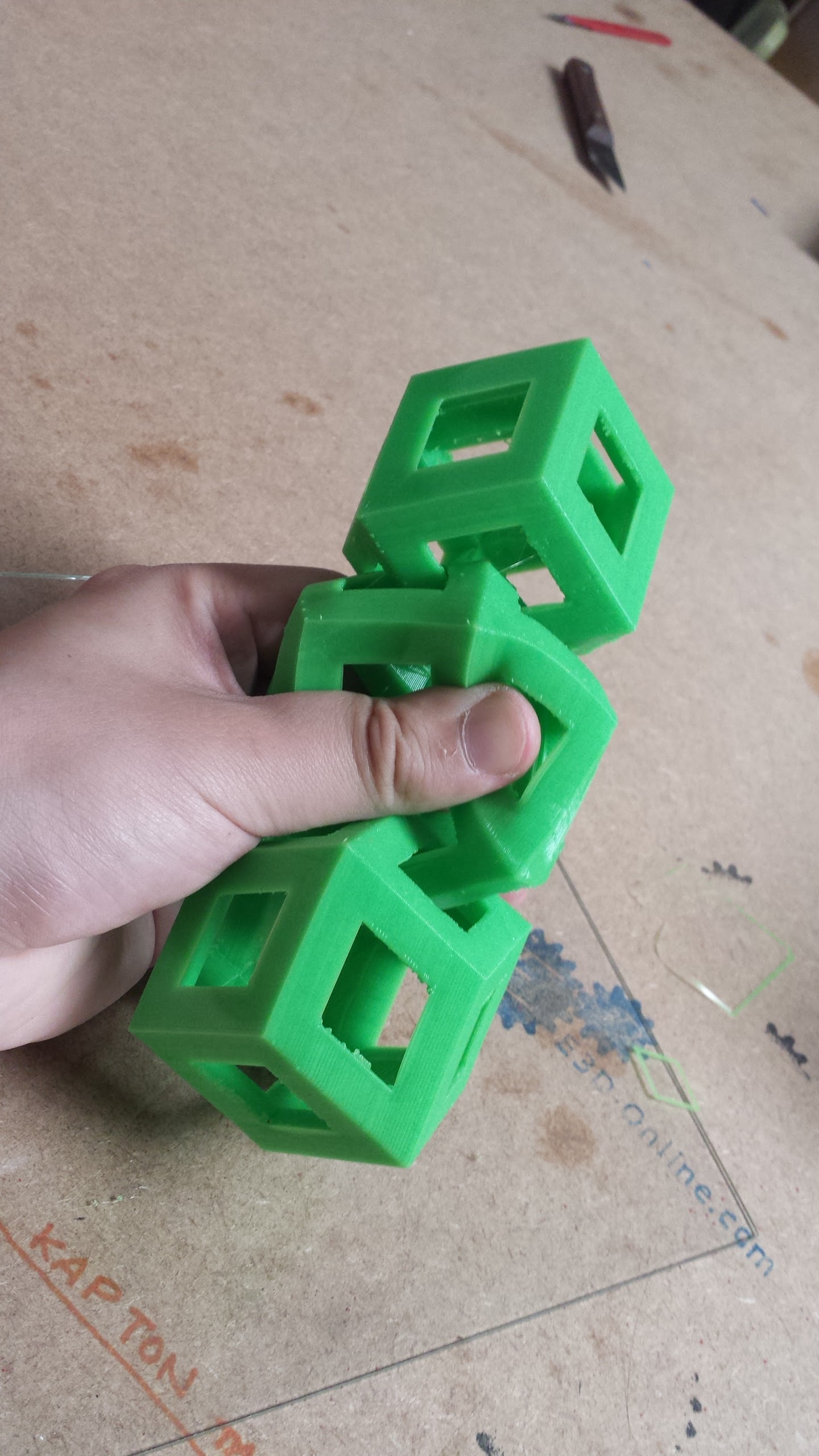

Been playing with retraction, temperatures, feedrates and NinjaFlex. Managing to get really clean prints now which is a big improvement over the stringy messy prints one would normally expext in a flexible material. These pictures are straight off the printer, no clean up done.
Its not perfect as there are still some small blobs to battle with, but it’s encouraging. I’m also really impressed by the bridging on this stuff, I expected it to be pretty tragic but its actually very nice. Especially as this was printed over a 75c glass heated bed with no print fan to tighten up the bridges.
Emmets dodeca chain, scaled up 150% and cut down to just 3 links. Mendel90 with an E3Dv6 printing grass green ninjaflex. 223c nozzle / 75c bed. 1.3mm retraction at 75mm/s. 20mm/s print speed for all parts of the print. 150mm/s travel speed. Cura.

I have very good results with almost the same settings and also an E3D hotend. My settings are: hotend temp 225, heated bed 60, retraction 1 mm and 60 mm/s and speed 30 mm/s also using Cura. I have tried with black Ninjaflex.

This was done with 1.75mm filament, which is half the challenge! 3mm flexible is pretty easy stuff to deal with in comparison.
