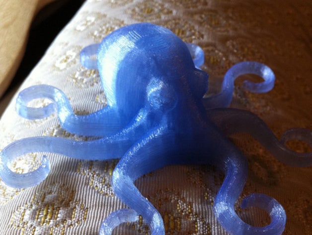

Been playing with tiny 0.25mm nozzles and 0.075mm layers. This is a tiny octopus.
PLA, Cura.

@Sanjay_Mortimer what scale?
30% on this one as I recall. With 0.075 layers.
