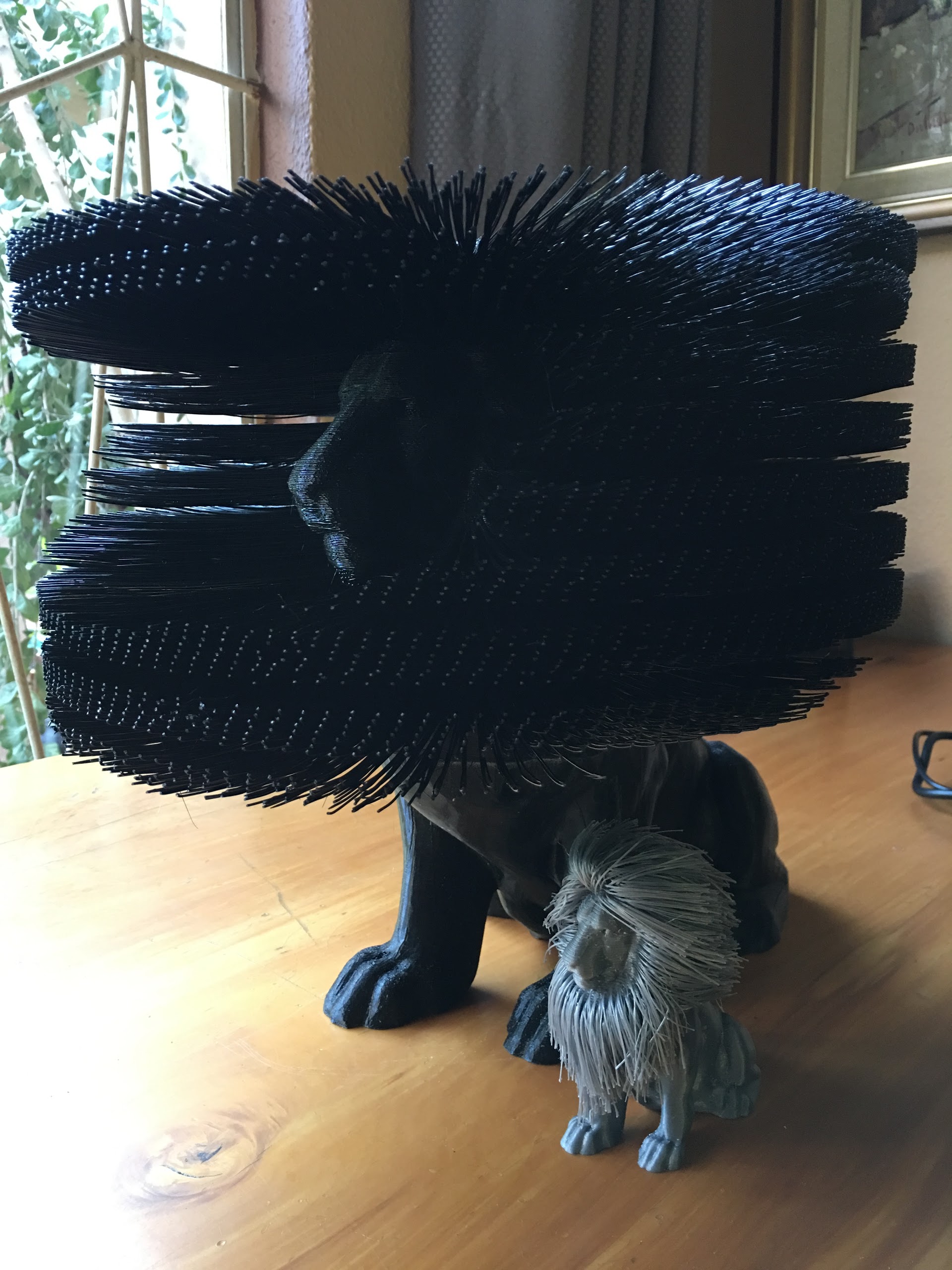

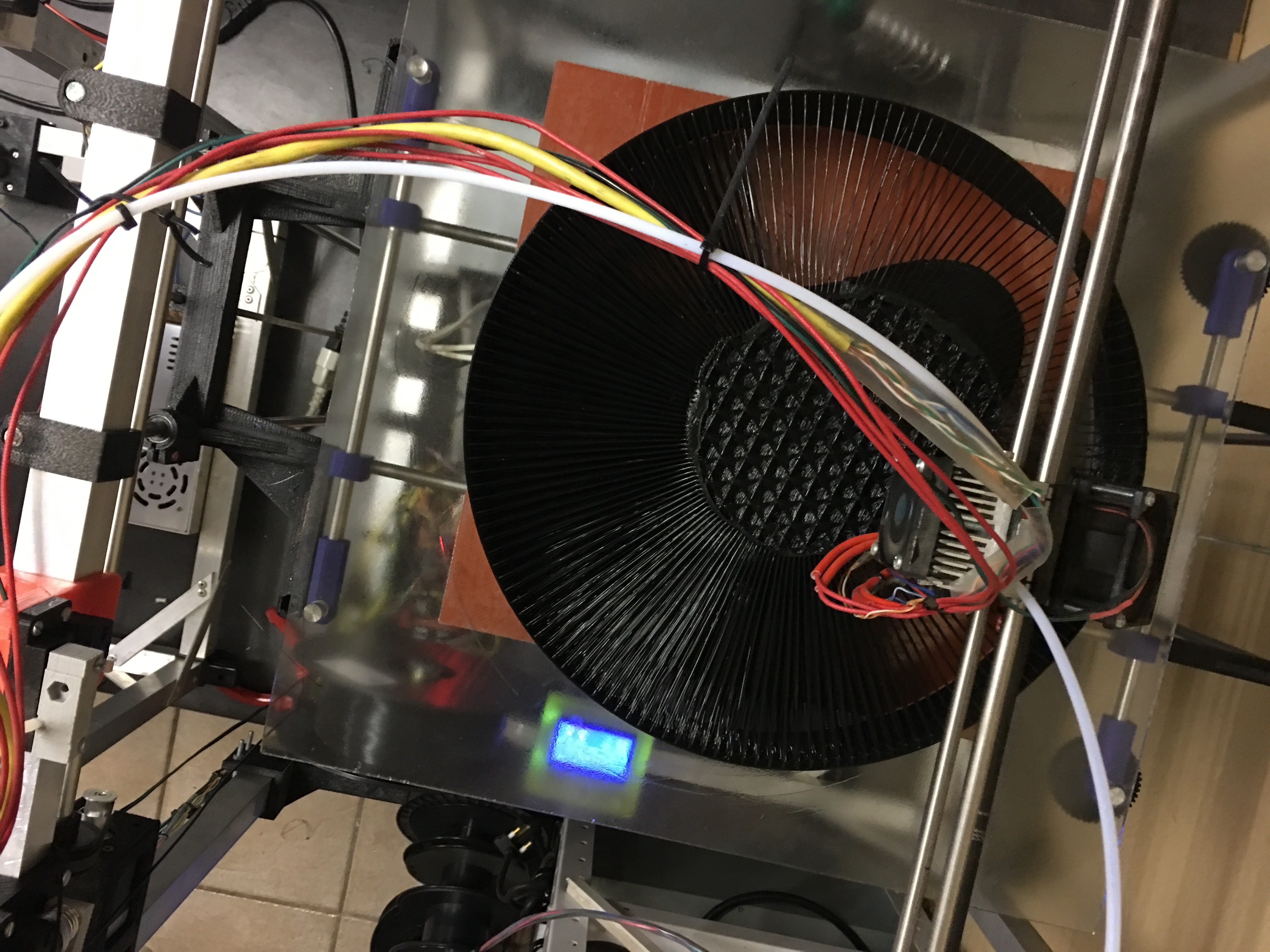

Been printing the large hairy lion.
Been printing the large hairy lion. It’s been going for nearly 40 hours and maybe another 10 to go.
Woah. That’s all support material?

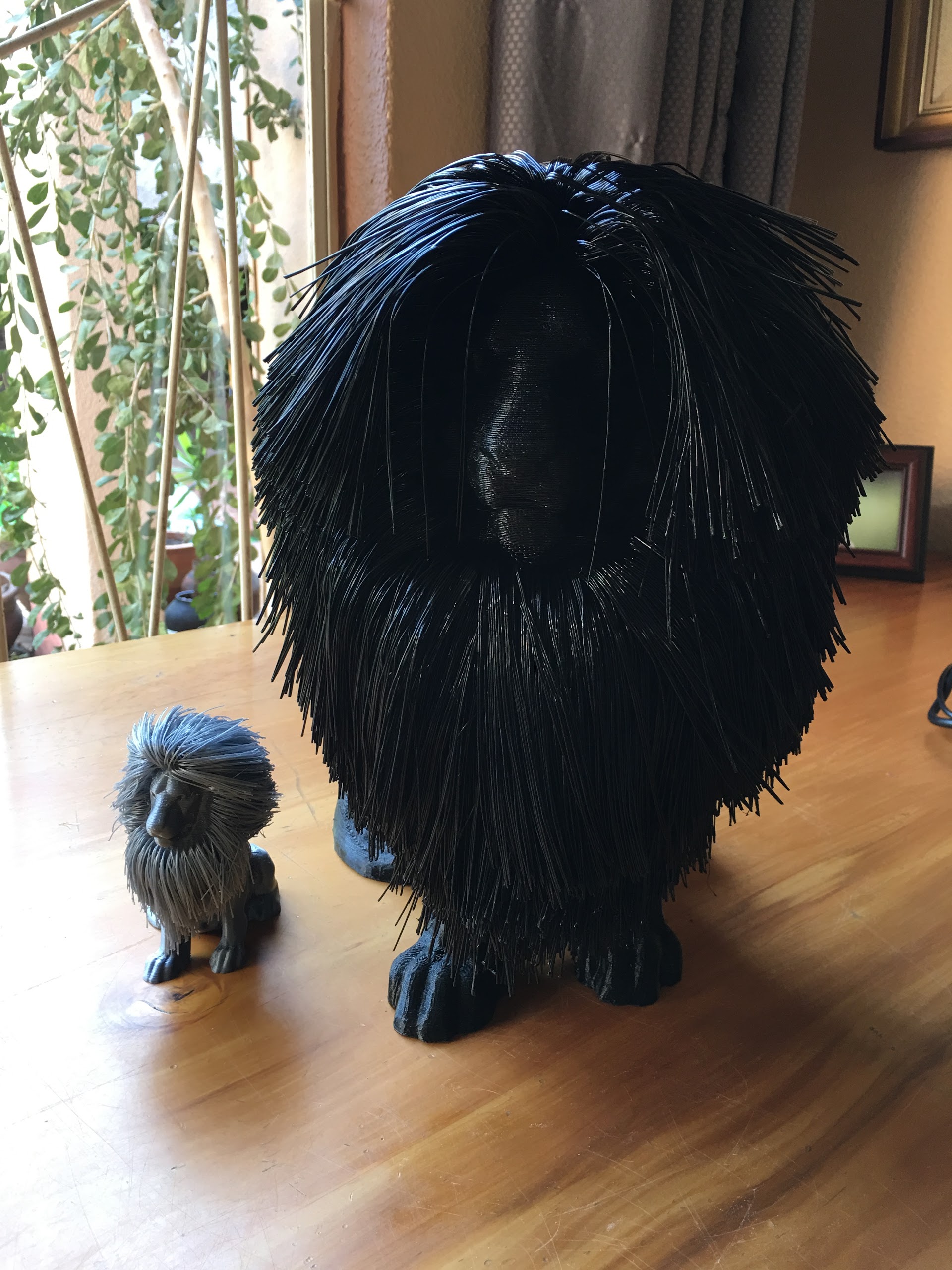

And its done
Total print time was days in total 68 hours.

Wait. So you like, comb out the material to make a mane? Slicing must take forever.
Slicing was not bad printing takes forever. As the main part gets smaller printing takes longer because each hair is printed individually.

@Michael_Scholtz I was hoping this was a video of removing the supports and releasing the strands.
@Matt_Harrington it was pretty straightforward. I cut around the edges and the ring itself also splits quite easily. Styling the hair is the hard part. I printed a normal size one to practice.
