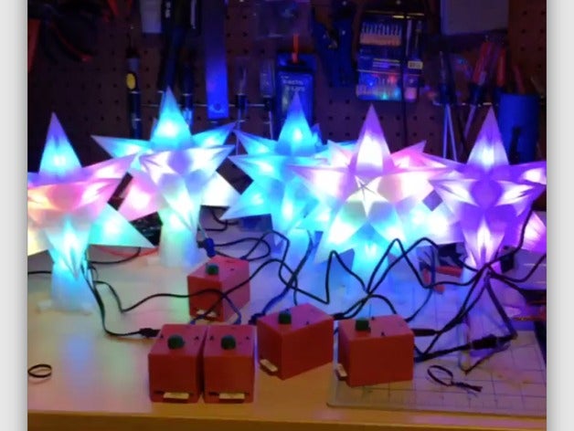

I like clear PTEG. The stuff from eSun works great at 235C. If you don’t want to model anything and want to get blinking relatively fast, this star is pretty cool. It uses the standard bullet pixels.
