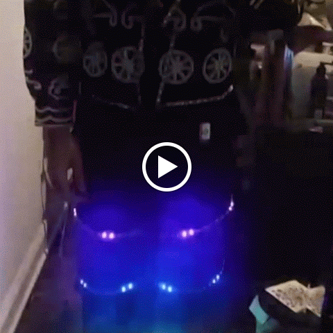

Been using FastLED for a while,
Been using FastLED for a while, decided last week that I wanted to make an LED lined suit, and here I am less than a week later with such a thing! I was just reading today about all the new 2.1 features, and I’m really excited to try those out because it will clean up my nasty code a bunch!
The top and bottom are controlled separately with more or less a matching pair setup: arduino uno, currently powered off a 9v, with the LEDs powered by the on board 5v (obviously Im not about to do full white full bright). I’m going to be powering with a 6600mah 3.4v LiPo each soon (theyre ws2812b, nominally 5v, from aliexpress). The top has 4 parallel data lines (though the animation is duplicated on each line in this example) and the bottom has 2. bottom is exactly 4m, top is sligtly less than 4 m. 60/m. I call this animation “rainbow seizure”
Hope to update with new animations!
