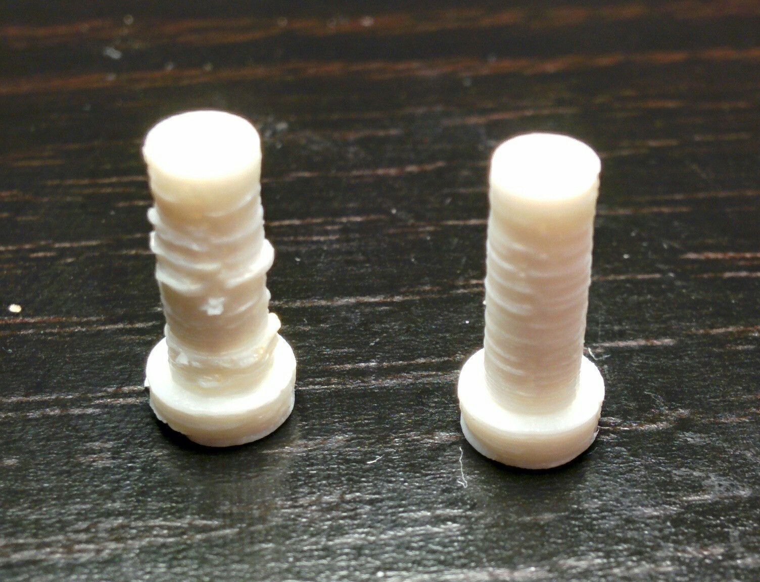

Before and after tweaking retraction settings
Why would this print need retraction at all?..
With retraction disabled, it would ooze. With it enabled, it would over compensate the retraction (left). On the right is it dialed in
Re the ooze, could it be that you’re printing too hot, possibly with a partially clogged nozzle? Also volumetric calibration ie with thinwall prints would be useful
250/110 ABS. Nozzle clear. Really do need to learn calibration better. Only ran through the guide once.
I have to tweak the cal and retraction when switching filament brands. Not all filaments are equal.
I’m printing abs @235/100
