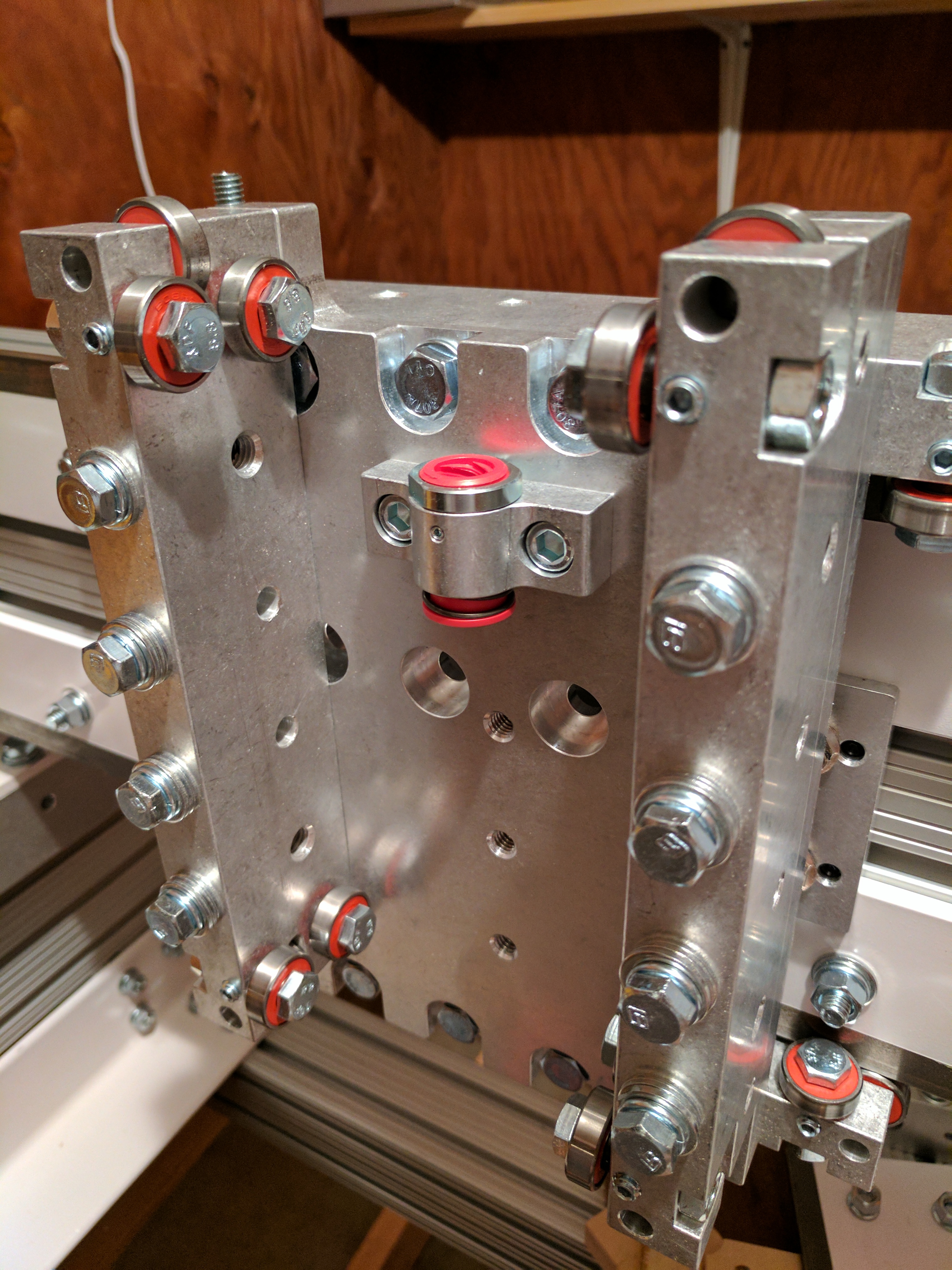

Begin my CNC build
Is there any adjustment possible in all those bearings?
Yes
