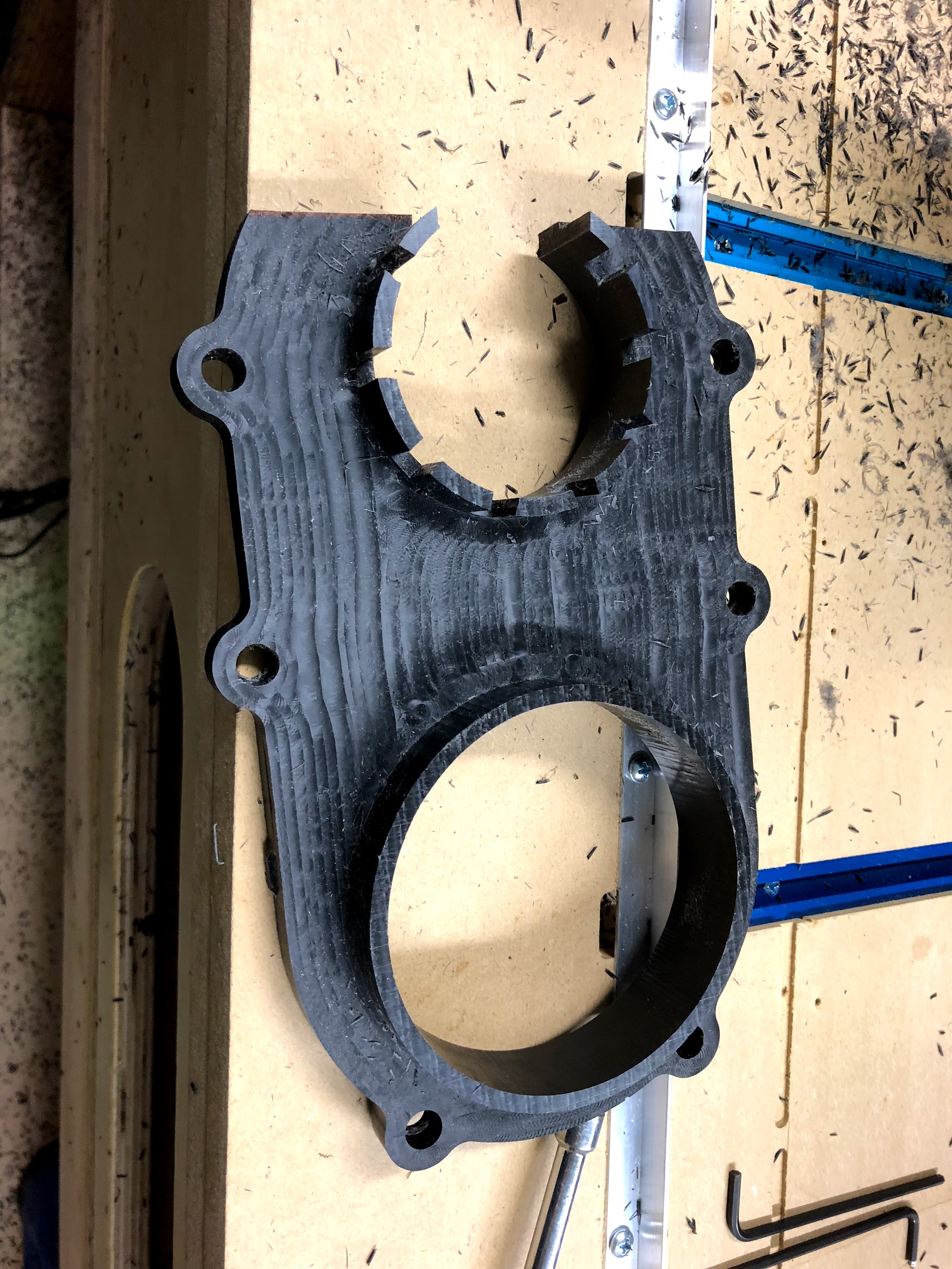

Beginning of a dust shoe. I used a fusion360 file available on cncrouterparts website and customized it for my r7. Working on the bottom part now. Will let you all know how it works out.
