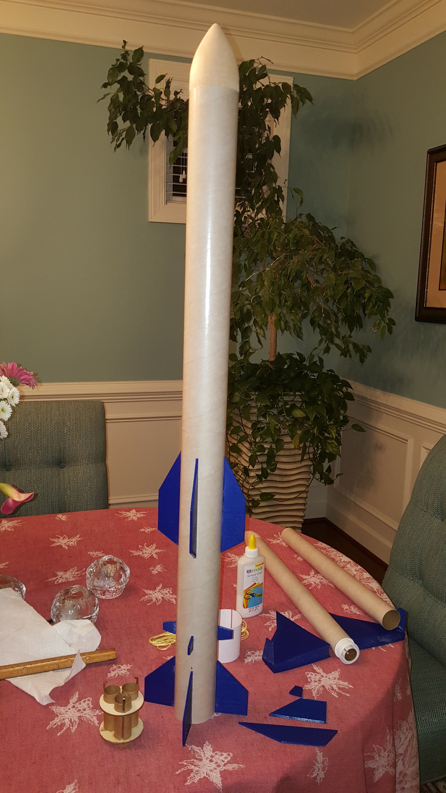

Behold! A hybrid-build rocket with 3D printed fins and traditional paper tube and balsa
Behold! A hybrid-build rocket with 3D printed fins and traditional paper tube and balsa nose airframe. This is an adaptation of the design presented in the Nov/Dec 2016 issue of Sport Rocketry, by Julian Kwasniewski (NAR 95955). I made the aiframe longer to accomodate the heavier fins, moving the CG to where it should be. All fins printed on my Printrbot Plus. The rocket takes 3 of the D12 class motors, although I am inclined to give it E class motors. She is a beast at 3ft of rocket sexiness…I plan to mount a camera and when she goes up in May. I’m even debating fall away/strap on boosters…

That’s cool, but wouldn’t it be easier to use paper or just cut plastic for the fins? Seems like that would only take a few minutes. I guess you avoid paint this way tho.
I wanted to get precise fins I can use on multiple rockets. This way I can print any quantity in any size. Plus I have very little post print machining, no grain issues and I can create all sorts of variations.
how you do it
@abubeker_khalid I am sorry, can you specifically tell me what you need to know? The airframe is made of BT80 tubes 18" long (x2) joined by a coupler. The nose cone is a suitable cone, and the engine mount comes from Sunward but is available from Apogee. I am using a kevlar shockcord for the parachute. The fins were done in TinkerCAD based on measurements in the Sport Rocketry article and printed to be 3mm thick.

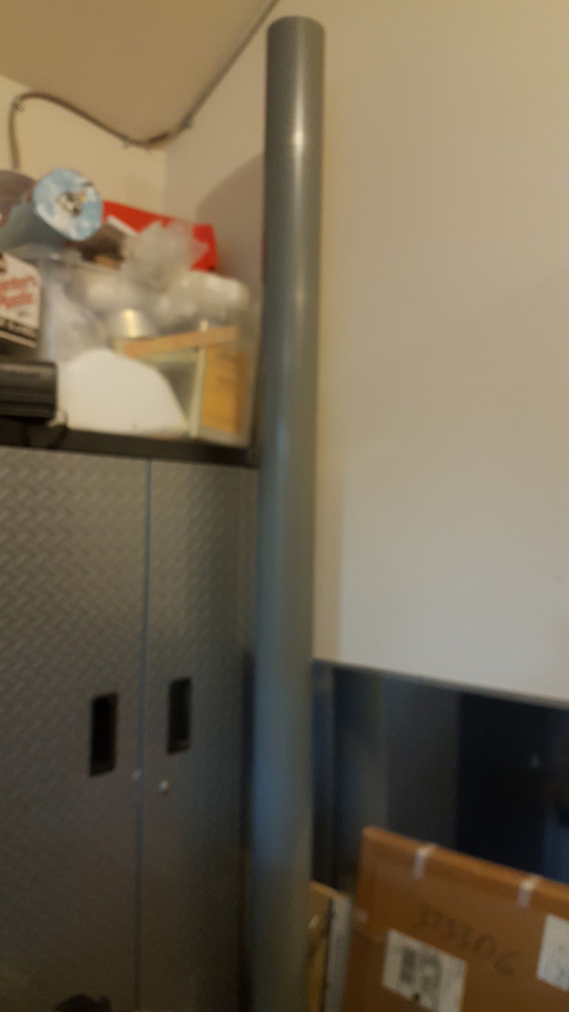

Too heavy like that. For that its PVC tube…like this one…
My garage floor cover came wrapped around it. Perfect for my next rocket beastie
I will look into it for my mid range ones too
