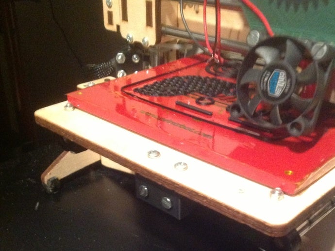

This was a very fun part of my 3d printing experience so far. So I used the zip ties to get it to print as best I could. I then printed this:
and with that printed good enough, I then printed a better version of it!
Once that was all good, I proceeded to print this:
Now it’s printing nicely! Still more tweaking I can do I think. (extruder temps, hotbed temp, fans etc.)
Loving it so far though.
