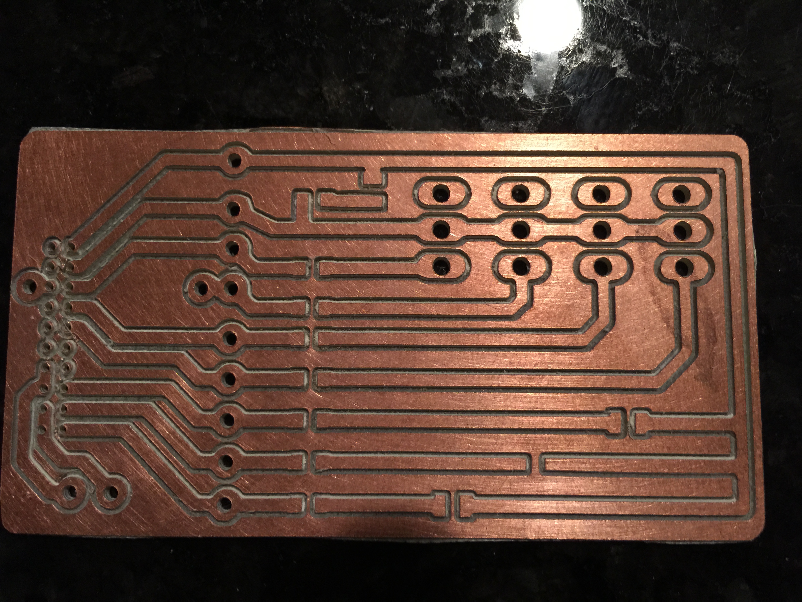

Best results yet using my 1Mx1M @ShapeOko with a 0.03" drill mill and @ChiliPeppr with auto level. Eagle to gerbers to Cambam.

@Ben_Delarre Dewalt DW660. @jlauer not yet I I plan too. Perhaps next board. @John_Anderson 0.35mm per pass 0.7mm DOC, F=165mm plunge=85mm. This was my first time using the .03" bit so I was conservative side but didn’t seem unreasonable in practice.

@Ben_Delarre It looks to me like most of the inaccuracies are from my structure and not from my spindle. Cut width is pretty darn close to 0.03" (using common low grade sliding calipers) but I can see some path slop. I think a more rigid machine would be required if I I were to route for fine pitch parts.
Would you be willing to post the Eagle CAM job file? I can’t coax the CAM job into generating through-hole pads with holes in them. Cambam will pull in my Gerber file and figure tool paths for isolation routing, but the through hole pads in the Gerber are solid, so I can’t tell Cambam to route the holes.
@John_Anderson I put it in my drop box here: https://dl.dropboxusercontent.com/u/2533490/2LayerForCamBam.cam
I opened the .drl file in CAMBAM and it made drills for me but I had to adjust the tool and the hole diameter to match. Then I had to merge the cambam files to combine the routing and drilling the CBFileMerge.py script (https://dl.dropboxusercontent.com/u/2533490/CBFileMerge.py) found on the CAMBAM forums.
@Brian_Beebe It works!! How cool. Thank you for your help sir.

This cut is really nice. Can you share some additional settings.
Type of bit (Flat or angled)
Bit size (.03" .762mm) that’s wide for most circuits.
Trace Isolation width
Trace width
Isolation Single or multiple passes
Depth: .7mm (2 passes)
