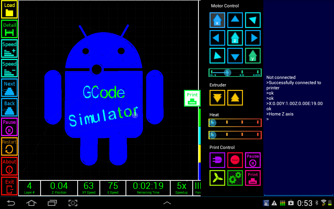

Beta test of GCode Simulator v0.99 for Android started ! The new version adds
The new version adds a printer control panel which can control a 3D printer (Sprinter,Marlin,…) using a USB OTG cable.
It does not support printing yet (next step)
Google offers a new feature for the Play Store to run new Apps through a closed beta test. The beta test is restricted to members of this community (3D Printing) . If you are interested in trying GCode Simulator v0.99 Beta just follow the link below. I tested with Samsung Galaxy Tab 2 only, feedback is highly welcome.

@Nicolas_Arias there are some usb debug apps in the play store. “USB Host Controller” and “USB Host Diagnostics” helped me. Gcode Simulator will connect to the first USB device with 115200 Baud. Does it show “USB Device found…”?

try the new version V1.02. A long click on the connect button will toggle the Baud rate (115200 vs 250000)
