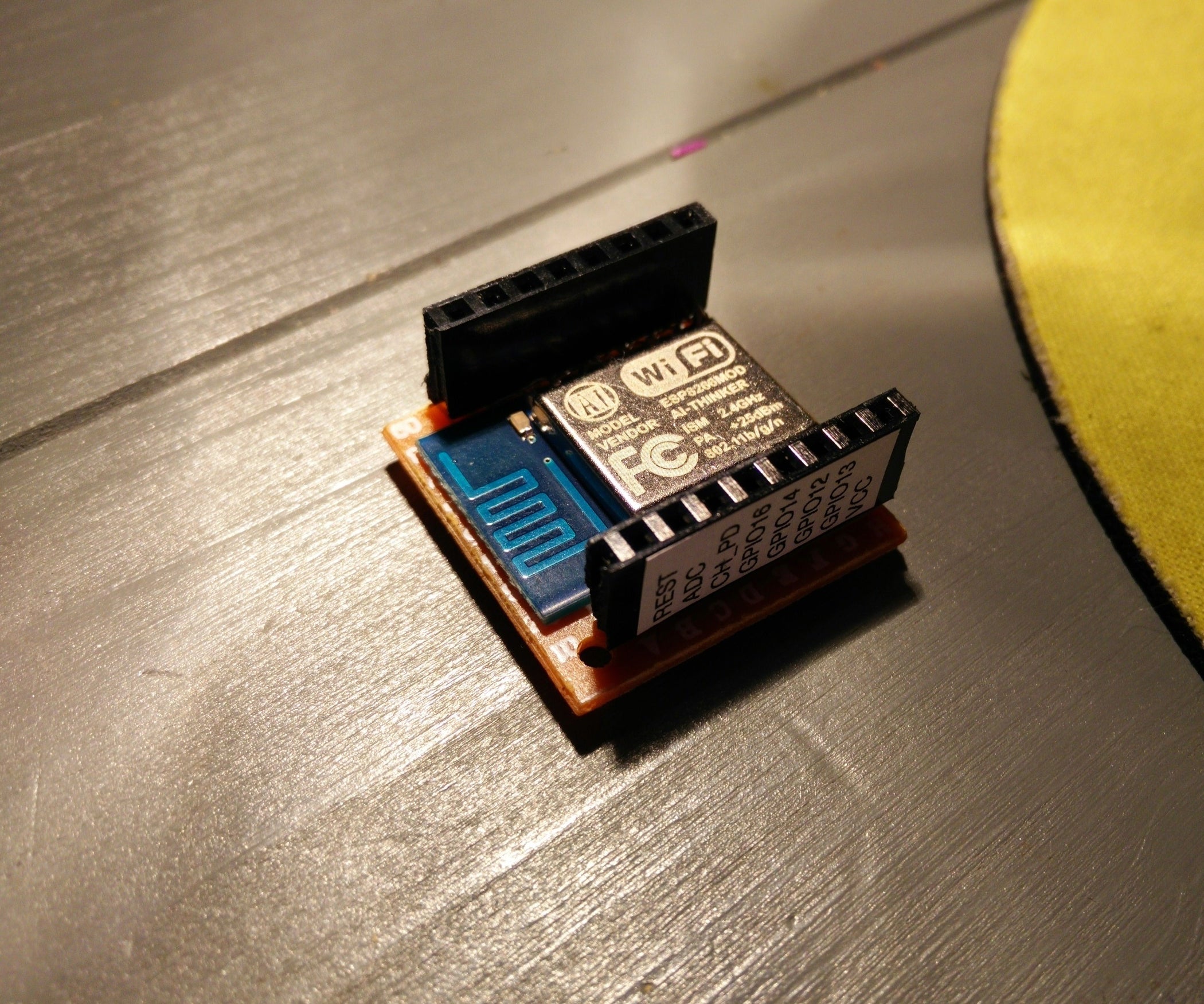

None of them - what would be ideal would be the smallest possible board with the pins on 0.1" centres - but with a 3v3 regulator onboard as well and the pullups. As for Lua, don’t let that influence your decision as you can flash that onto the boards at any time.
This guy has done a pretty good job giving 0.1" headers AND the regulator etc… and he’s selling the boards I believe… http://tech.scargill.net/dil-adaptor-for-esp07-and-esp12/
NodeMCU
I have a bunch of the boards @Peter_Scargill referred to and am very happy with them. Breadboard friendly, push-to-program, good power options. The ones I bought have the ESP-07, which means two antenna options. He is now offering more ESP module options. Great price, too!
