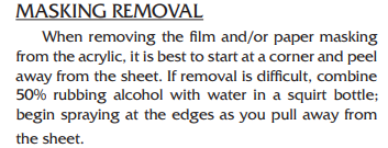

Dipping an end in 70% IPA actually helped loosen the film.
From the guide posted above.
