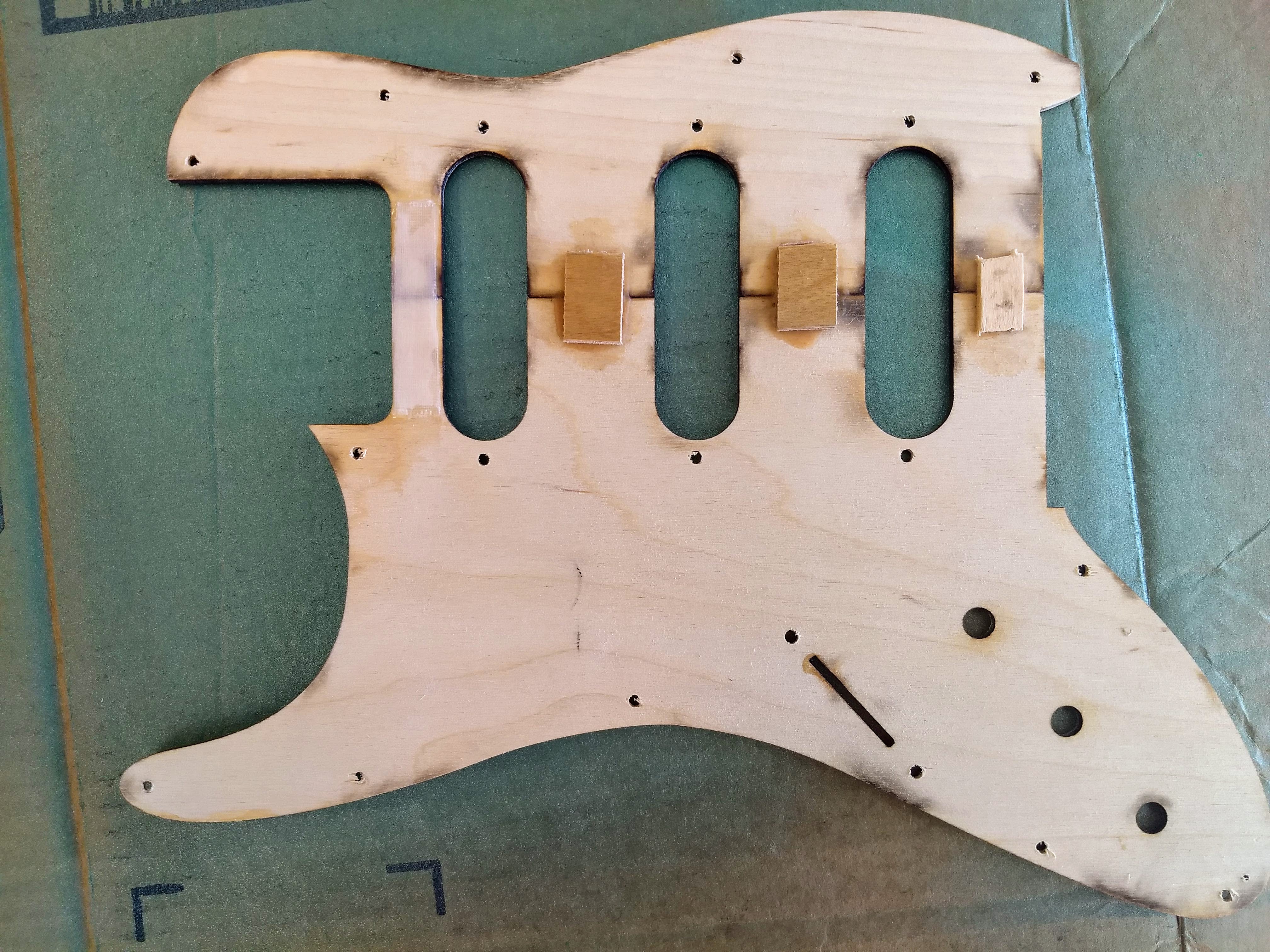

This is a bit of a rehash of what I posted a couple of years ago, but I’ll mention it again for those who might be newish to the K40…your projects are not limited by bed size. I have a vanilla K40 and I routinely make objects that are larger than 200x300. I design my object on Coreldraw, bisect it with the knife cut, and then cut separate pieces on the laser. The joinery is simple and basic; CN glue on the cuts and a wood or fiberglass doubler on the reverse side. Finish the seams with a thin coat of bondo or primer-surfacer. Once painted, all evidence of the seam disappears.
