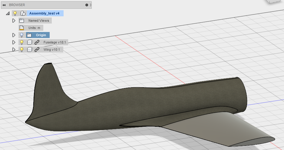

Bit more work from me. Been working on the blend between the wing and the fuselage. I’m liking Fusion 360 quite a bit so far.
The amount of design work required to make a project like this succeed is daunting for a single person. The amount of fabrication work is equally daunting.

I’m thinking the fuselage will be hollow to fit 3D printed framing. So It’ll be made in 2 halfs, glued together.

Do you have fuselage ready for test prints? I fooled around with the file but I’m still a hack :wink:
Not yet. I can get something ready for a test print though. Keep you posted.
