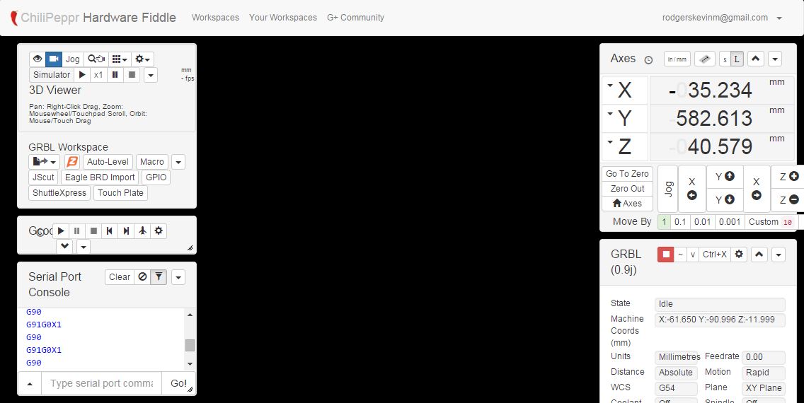

Any thoughts on why I would get a completely dark work area? Tried loading CP logo and got the same result. Was just able to get my X Carve connected a few min ago for first time. When I use my laptop (not connected to cnc) and drag files in they look great. Head scratch…
WebGL doesn’t work on your computer then. I recommend you run serial port json server on that box and then run ChiliPeppr on your new machine.

Super confused now. Easel uses WebGL for the preview thru Chrome and that works on both laptop and the connected desktop. Both machines are Win 7 64 bit. John, any other options? I specifically bought that desktop for this cnc, hate to throw it out.

I recommend folks run SPJS on the low-end machine and then run ChiliPeppr on a high-end machine. CP does require some decent CPU for the 3D viewer, so it’s worth getting something worthwhile. However, I’ve heard even $300 chromebooks run it great.
