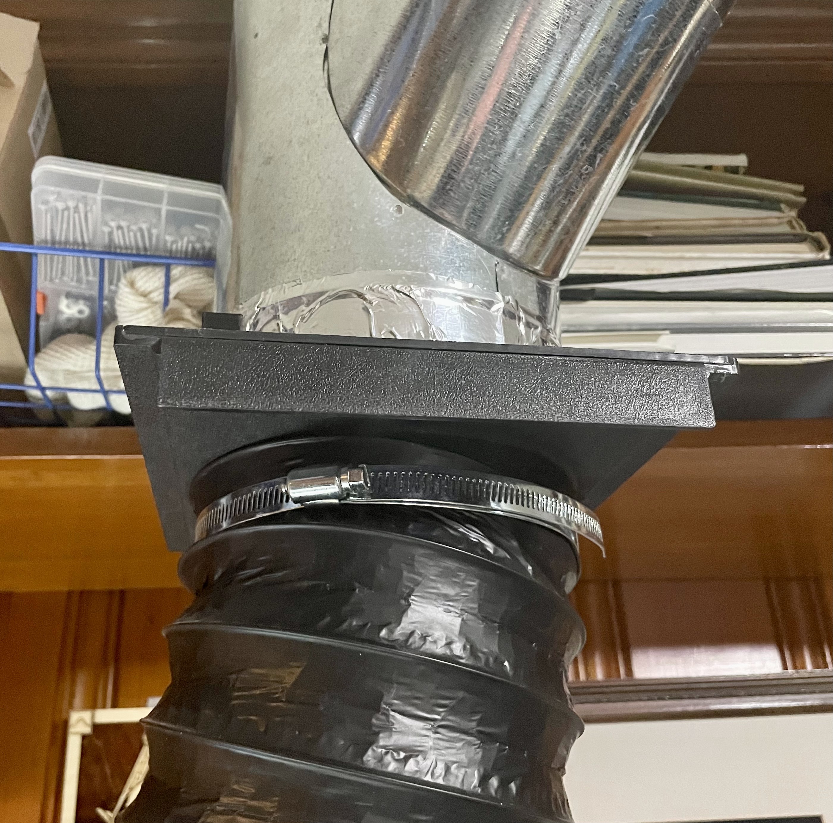

When I got my 50W laser I had to upgrade the exhaust to a 6in trunk and added a blast gate to allow me to also plumb in the K40. Also seals the 50W from outside air that may leak in. The blast gate is black and is overhead as my exhaust goes out through the roof. Because of this I can occasionally forget to open or forget to close the gate.
I’m more worried about forgetting to close it as the damper on the roof vent isn’t air tight and, during the summer, warm moist air can leak in and cause a condensation rain storm in the laser (which has happened once :scream:)

The hall effect senor was mounted on top of the blast gate housing and a magnet was embedded in the sliding gate at the same position as the sensor. The rest of the circuit was housed in the thermometer housing that I had 3D printed before that sets on top of the laser with the LED on top of that.
I 3D printed a housing for the sensor. This isn’t really necessary as you could just hot glue the sensor in place. The sensor was mount to a piece of solder board and hot glued in place.
Drilled a 8mm hole in through the top of the gate housing and into the gate. Opened the gate and finished drilling the hole. Mounted the sensor housing to the gate housing in the drilled hole. I used two 1.5 x 8mm rare earth magnets, stacked together, to embed in the 3mm thick gate. Had previously determined the correct orientation of the magnet.

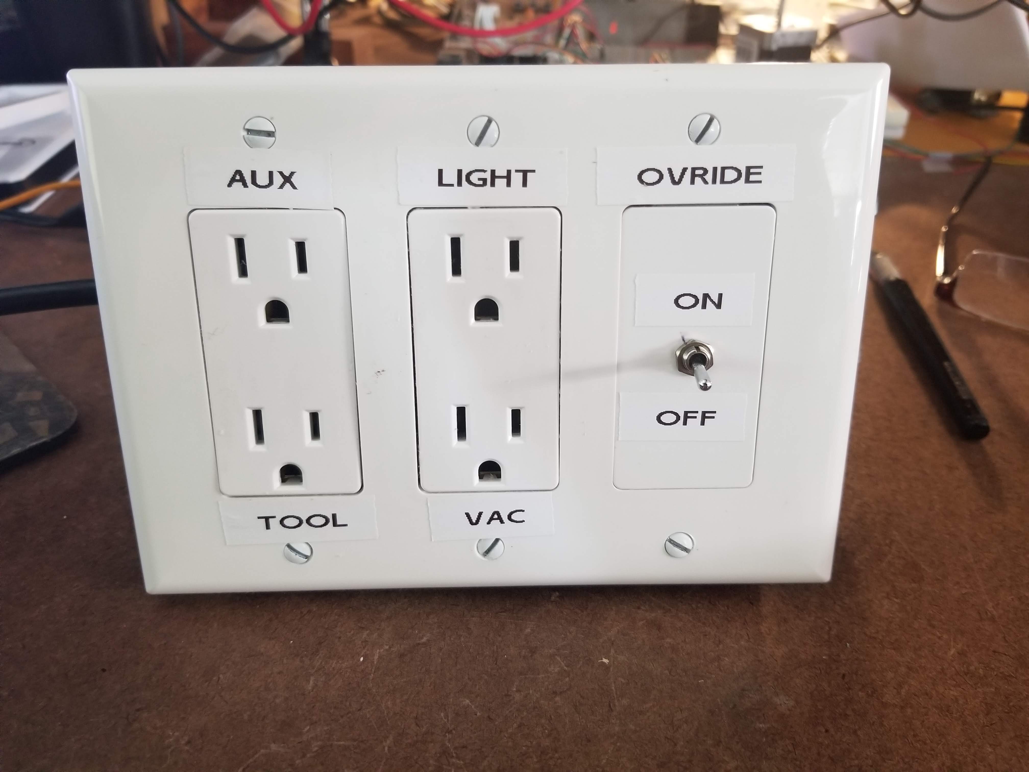

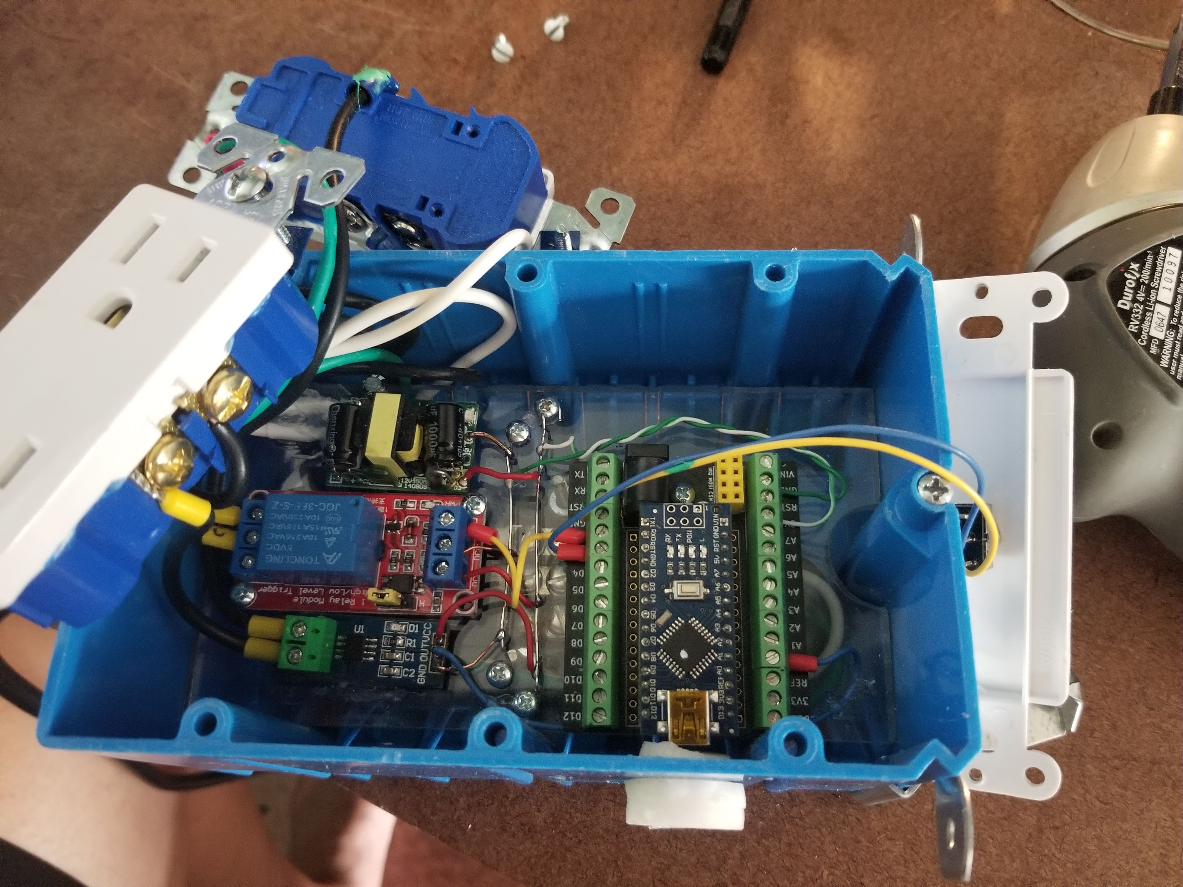

I have a controller I built that turns on a local vacuum & light when the drill press is turned on.
I have been surprised by how useful this turned out to be.

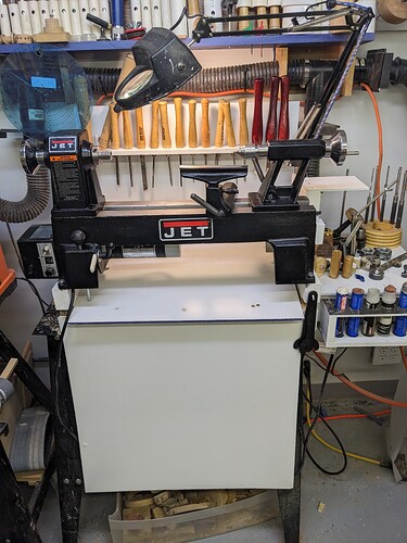

It dramatically reduces the swarf from my drill press as I was always too lazy to bend over and turn on the vac, especially for short jobs.
I have on my endless list of projects to add a radio link to this schema and that will allow me to activate a vac in a similar way but from more than one tool location.
In this configuration, each tool has a sender and the vac has a receiver. There is also a hand remote.
Yeah, you can buy these but they are too rich for my blood, and what’s the fun in that anyway!
