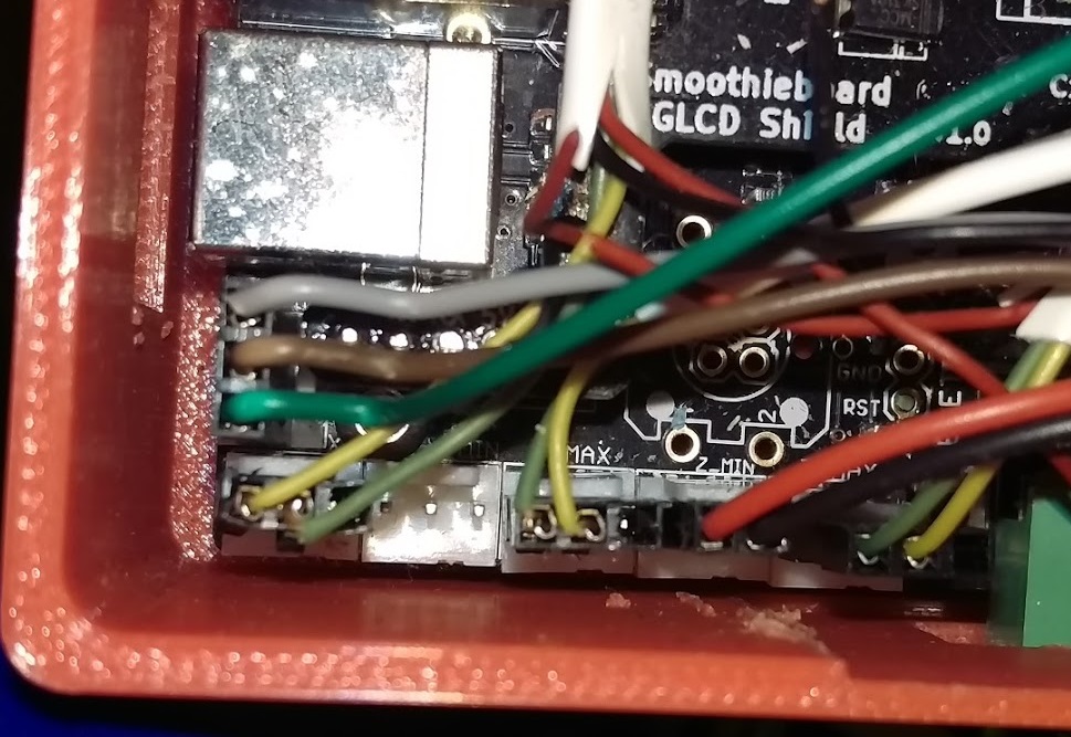

The photo attached will need my explanation just a tiny bit.
My Delta is five feet tall..so the wires changed colors on the way back to Smoothie.
Here is what makes BLTouch seem hard to figure out. The TWO and THREE pin connectors they supply need to be separated into a different group.
If you are not using MIN endstops, it does not matter which set of pins you use for signal from BLTouch back to Smoothie Servo module, so with that said…this is my color conversion chart…sorry
BLTouch WHITE wire to Smoothie RED wire in photo
BLTouch BLACK wire to Smoothie Black wire in photo
BLTouch ORANGE wire to Smoothie GREY in photo
BLTouch RED wire to Smoothie GREEN in photo
BLTouch BROWN wire to Smoothie BROWN in photo..(oops)
ZMin sees the BLTouch as a simple switch ( I think)
So ZMIN Pin 1.28 and GROUND right next to it are your switch terminals for SMOOTHIE input
I then went to XMin terminals to effect control and supply power to BLTouch.
Pin 1.24 is the switch output pin, so Smoothie communicates with BLTouch on that pin, (grey wire in picture)
Next to that is simply power and ground so BLTouch can self test and operate it’s tiny parts
