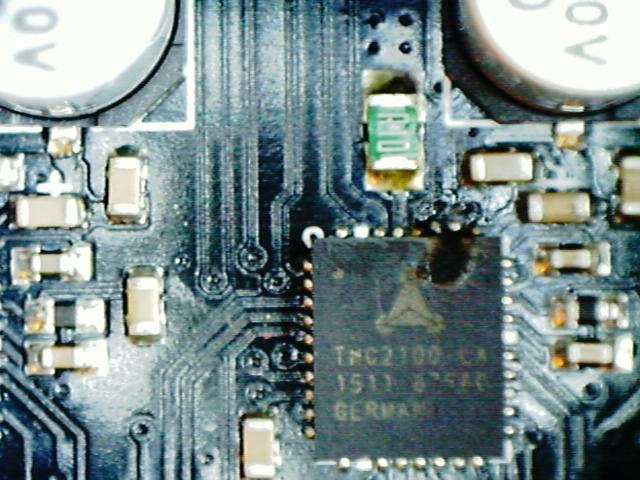

After 2 hours of control and reconfiguration in REDEEM, I to connect the Y motor on the stepper X. And it works …
I remove the REPLICAPE and examines the pins, I see nothing , but the Y TMC2100 seem’s have a short-circuit of track right to the exit. Did you already see that?
While waiting for my new REPLICAPE, I will continue integration and playing with slave_y=h
