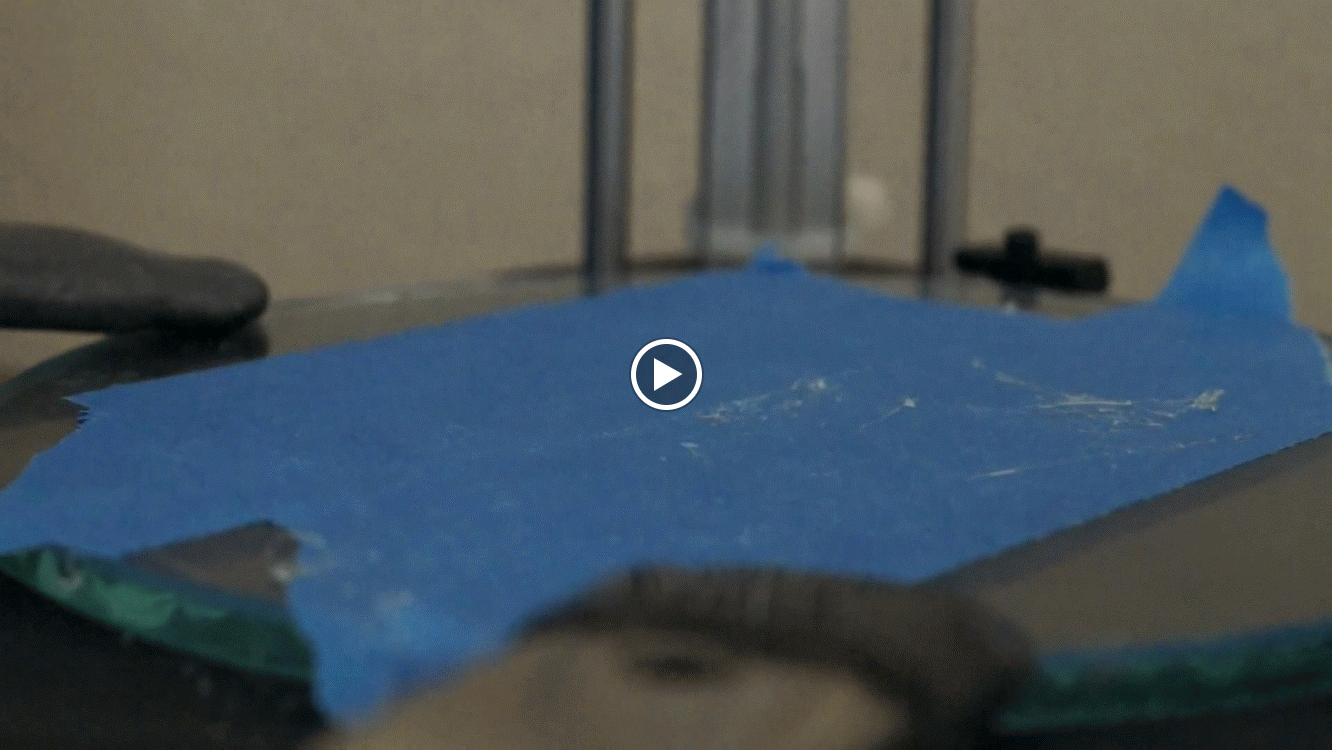

Boogers. I have an $800 boogermaker. :smiley: I’ve got the extruder extruding with light pressure, I’ve got the head just barely touching the bed when it starts, I’ve got Slic3r printing the first layer at 205 and everything else at 200, I’ve taken Rubbing Alcohol to the blue tape based on a youtube video I found…What am I missing? I’m hoping there’s someone out there that’ll look at it and say “Yup, you gotta misaligned flanger.”

It’s manually extrudes perfectly with the nozzle in the air, extrusion happens with no stripping or binding…the values may need to be adjusted, but they’re in the ballpark.

I don’t know if its the video playing a trick on me, but it looks like your nozzle tilts a little towards the direction its moving. Which would make the trailing edge getting to low and removing the applied material.
Or you might be under extruding the material. Have you measured the filament movement?
