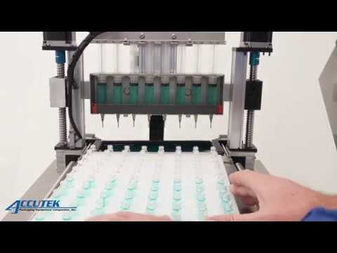

What I’m trying to accomplish is something very similar to this Accutek Mini-Doser:
Automatic Precision Mini Dose Filling/Dispensing Machine - Accu-Doser - Accutek Packaging Equipment
I was about to go with peristaltic pump, but the syringe, several fills at a time, has me considering the cleanup as I switch colors (forgot to mention the use-case… we make and bottle small jars of ceramic stains and paints).
When I saw the Mini-Doser in person, it reminded me of my 3D printers with their stepper motors and lead screws, etc. which got me thinking it’s conceivable to build… you know?

Dispensing:
Pinch fill: Timed Flow Volumetric Filler - Pinch Series - Accutek Packaging Equipment Companies, Inc. - YouTube
Syringe: Automatic Precision Mini Dose Filling/Dispensing Machine - Accu-Doser - Accutek Packaging Equipment - YouTube
Perhaps a cleaning cycle prior to changing paint color. Move to a trash tray, expel the paint and then switch to a solvent and pressure clean the dispenser. [how do you know it’s clean].
A mechanism for accurately plunging the syringe?
