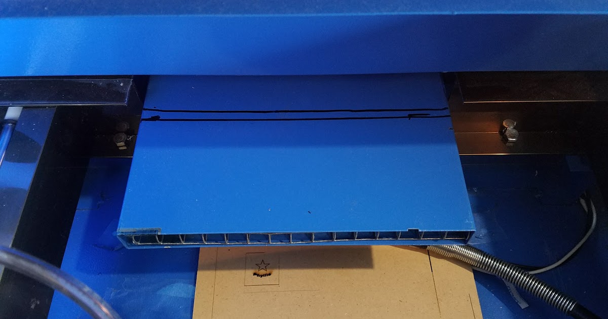

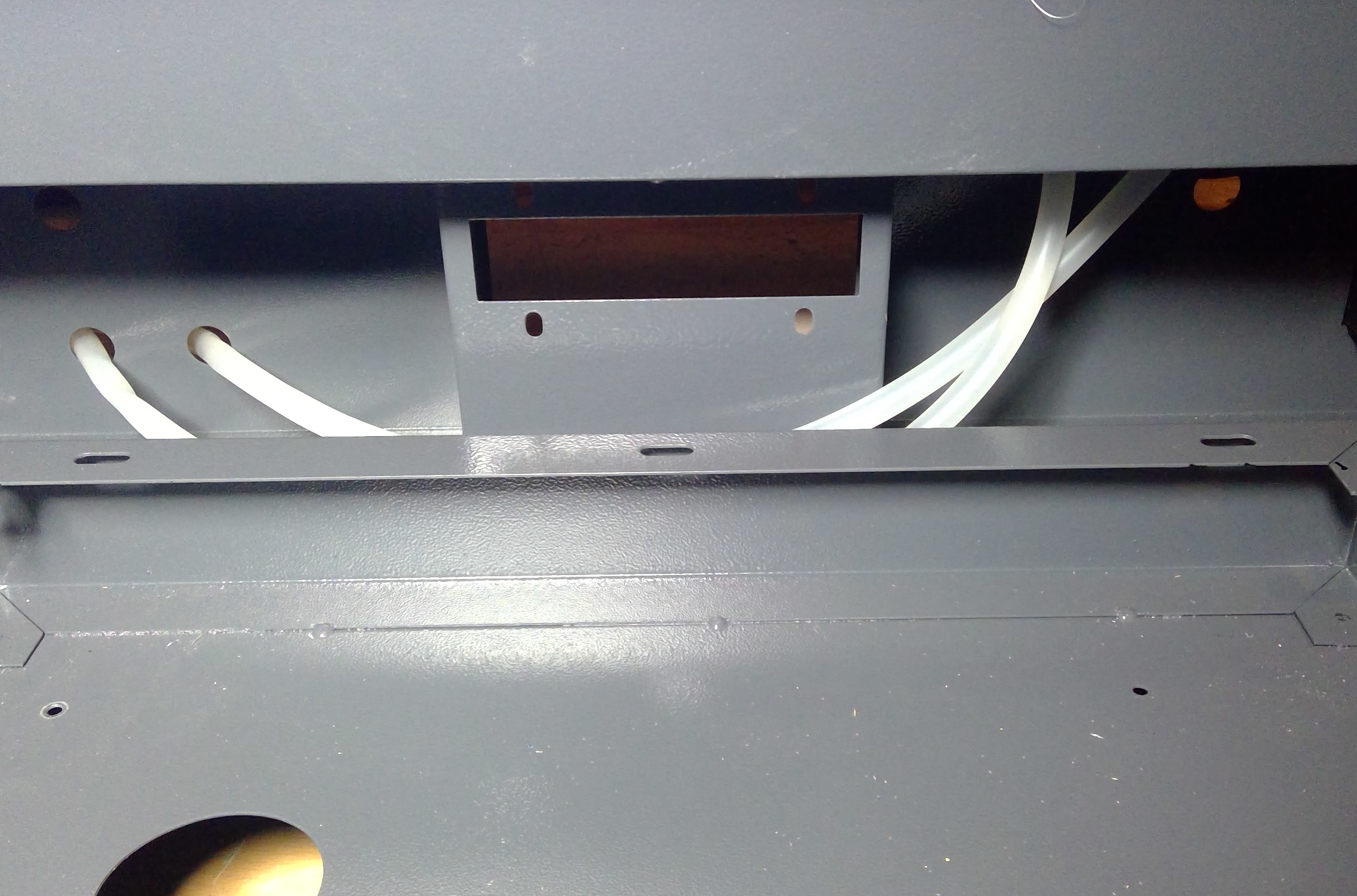

Did your unit have the boxed in area where the original fan sits, and then a small rectangular cutout that allows flow from the work area? Ill have to post up a pic its difficult to describe. Seems that would be fairly restrictive to airflow, so I had planned to make the opening into the work area larger, but if this is un necessary I wouldn’t mind forgoing it.
A picture of the duct would help. I cut out most of the took out the restrictor if that is what you mean.

Here is what I have going on. The duct is similar in to yours and can be unbolted from the rear of the work area. I am thinking of enlarging that opening so there is better over all ventilation into the work area.
