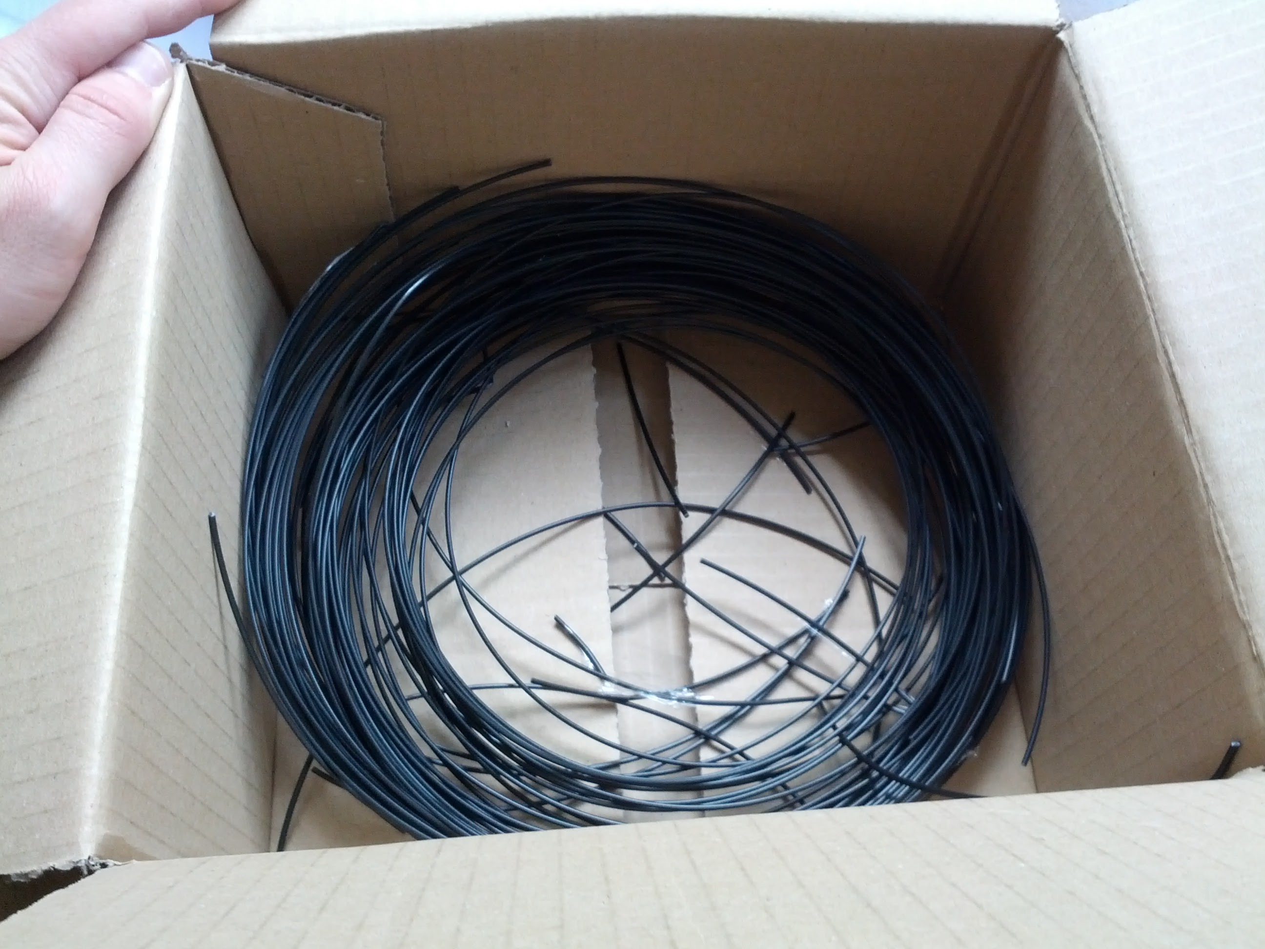

Bought some ridiculously cheap filament - 1kg 1.75mm ABS for 19.89€ shipped, through ebay.
Bought some ridiculously cheap filament - 1kg 1.75mm ABS for 19.89€ shipped, through ebay. As expected, there was a catch: The saran-wrap-like wrapping on the outside of the roll somehow reacted with the top layer of the filament - not only did it stick enormously well to it, but it somehow also made the filament extremely brittle. I ended up un-spooling about 120g of filament to get to the good part, which now prints reasonably well (at 260C in the well-ventilated basement).
The seller already offered a full refund, which i gladly took. I mean, i’m not going to say no to free filament.

this black color filament is probably made by chopped scrap plastic and this is why it’s so brite, there is no way adhesive tape to make chemical reaction with the filament :)))

On this filament, only the outer layer (first 120g) was brittle - and i mean, really brittle. It would fall apart even if you simply tried to un-spool it. The rest of the filament is fine, though, and i’ve printed about 100g so far without incidents. That is, after i cranked the temperature to 260C (E3D v5 with the standard 0.4mm nozzle).
I could not use either of the spools I had with the same issue. It won’t bend, just breaks or won’t un-spool and extruder grinds groove into filaments.
