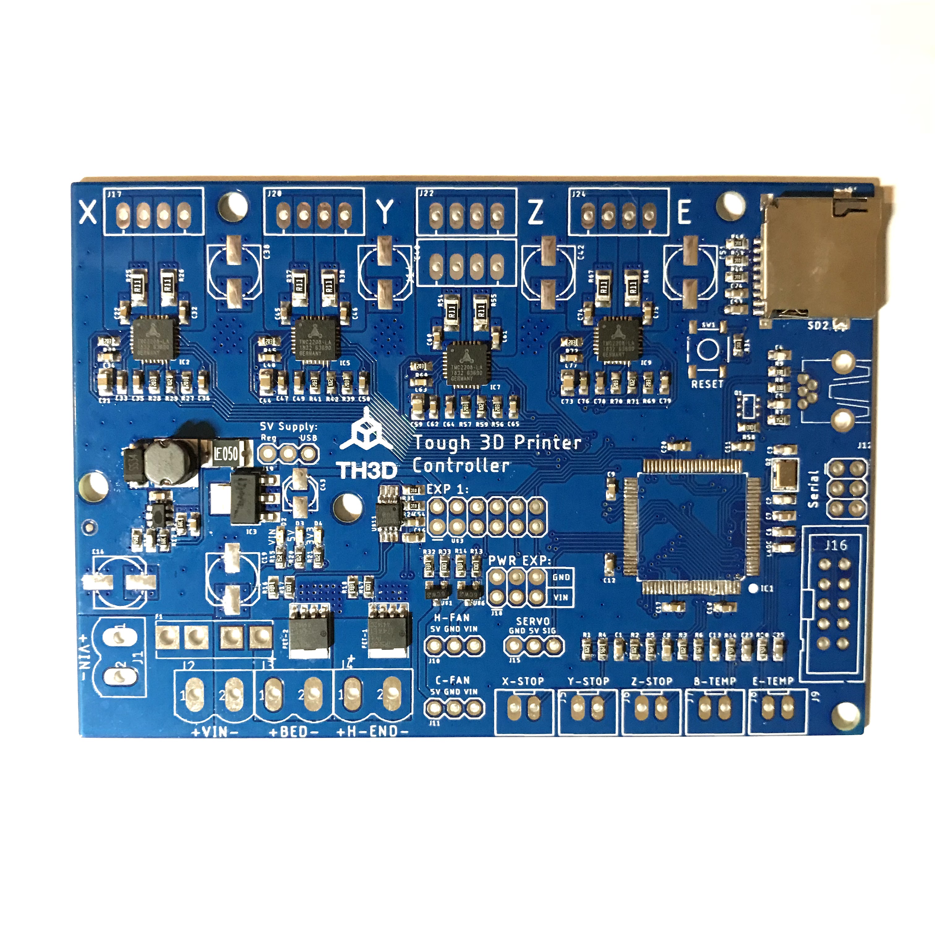

Brain surgery coming soon! Really excited for this board I’ve been working on. Hoping to throw it in the Ender 3 this week.
What are the specs on it?
@funinthefalls 4 TMC 2208’s with UART support natively, 32 bit M3 processor at 120mhz, automotive input fuse, Phoenix contact screw terminals, 5th driver expansion header, and final version will have reverse polarity protection.
This is made as a drop in replacement board for Creality printers (CR10, 10 Mini, 10S, and Ender 3).

I appreciate the automatic bed leveling technology. Does this board support this, or is that separate from the controller board you are presenting here?

Ender 3 is on order, this board is very interesting and I’m looking forward to it becoming available. I can’t imagine that the addition of an EZABL was overlooked?
@Temujin_Kuechle yes! We will directly support auto bed compensation. You can use a BLTouch or EZABL directly with no additional wiring needed!
@Chris_Setla_kaptain much appreciated! And nope definitely not overlooked. The EZABL will plug right up to this. We have worked with TH3D directly to ensure their upgrades for the Creality machines are plug and play for this
