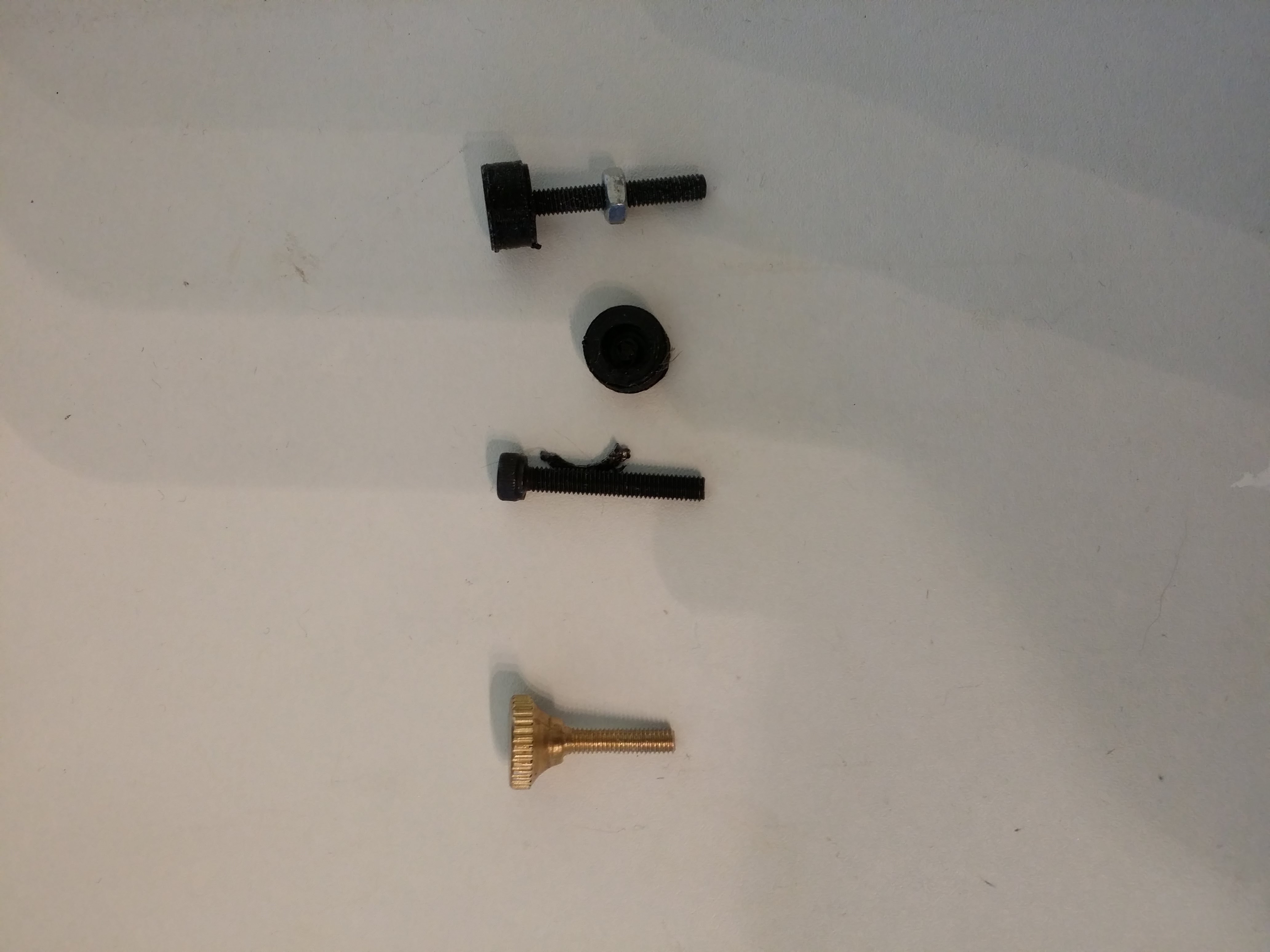

My first mirror was loose on the mount so I removed it to tighten and clean it. While doing so I bent the brass adjustment screw. Needing one quickly, I went to the local hardware store and purchased some M3 .5 x 20 mm cap head screws. I 3D printed some caps and I am back in business. The new screws are hardened steel so they will not bend!
