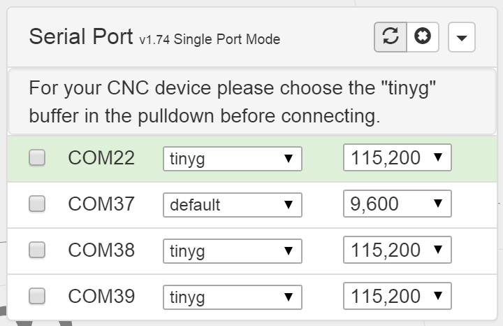

Bug fix for those on Windows where the “Friendly” port name plug and play serial port list query was failing. You will at least see a list of COM ports now.
John, I finally finished building a ShapeOko with a TinyG controller. I stumbled upon your ChiliPeppr web interface and have been trying to use it. When I try to install the latest Serial Port JSON Server it fails and it says “Verbose Mode not specified, stopping all further logging”… Not sure what that means of how to fix it… I’d appreciate any help!
Actually, that is a great response. It means you are good to go! Your SPJS is running fine. You should now just connect to it from your browser and you’re good to go.
