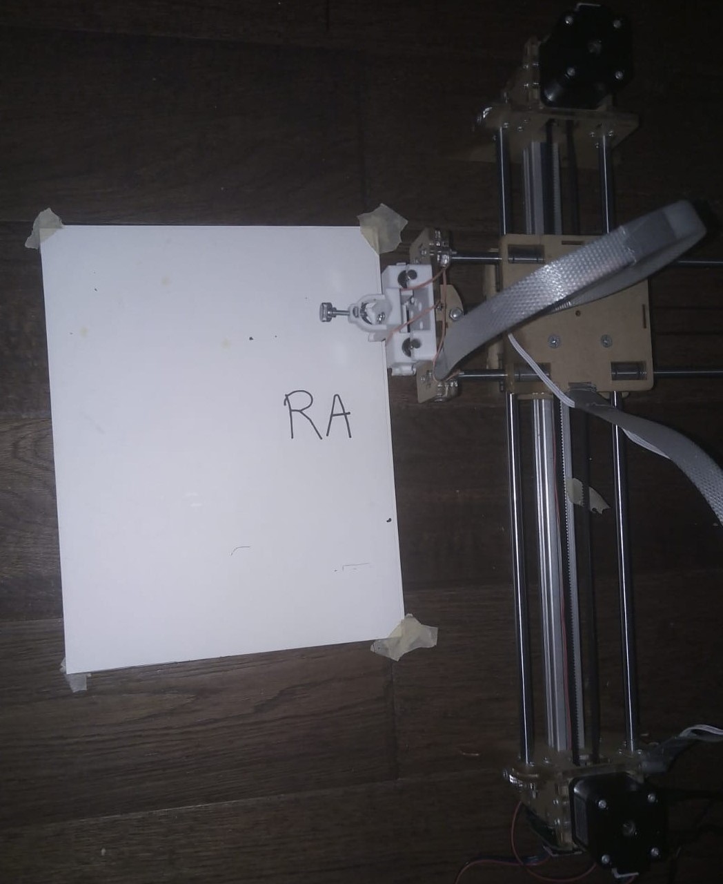

I have a X Y plotter like this:
And would like to build a feed paper but not big like this
I would like to make something flat, about 3cm high and able to load several pages one by one.

To start I would get a dead desktop printer from a thrift store and gut it for the paper/document feeder section and then add your own Arduino controller.
I suspected that it would be complicated, I intend to meet the challenge.
I’ve already boned an old printer and wanted to make sure there wasn’t an easier way before embarking on an adventure full of peripety.
I can guarantee peripety after all this is making :)!
The key is getting the friction on the picking mechanism right. That is why the feed rolls on printers are a good start. Then getting proper feed registration can be a challenge therefore pay careful attention to the printer papers path. HP, that is Cano, has this down!
