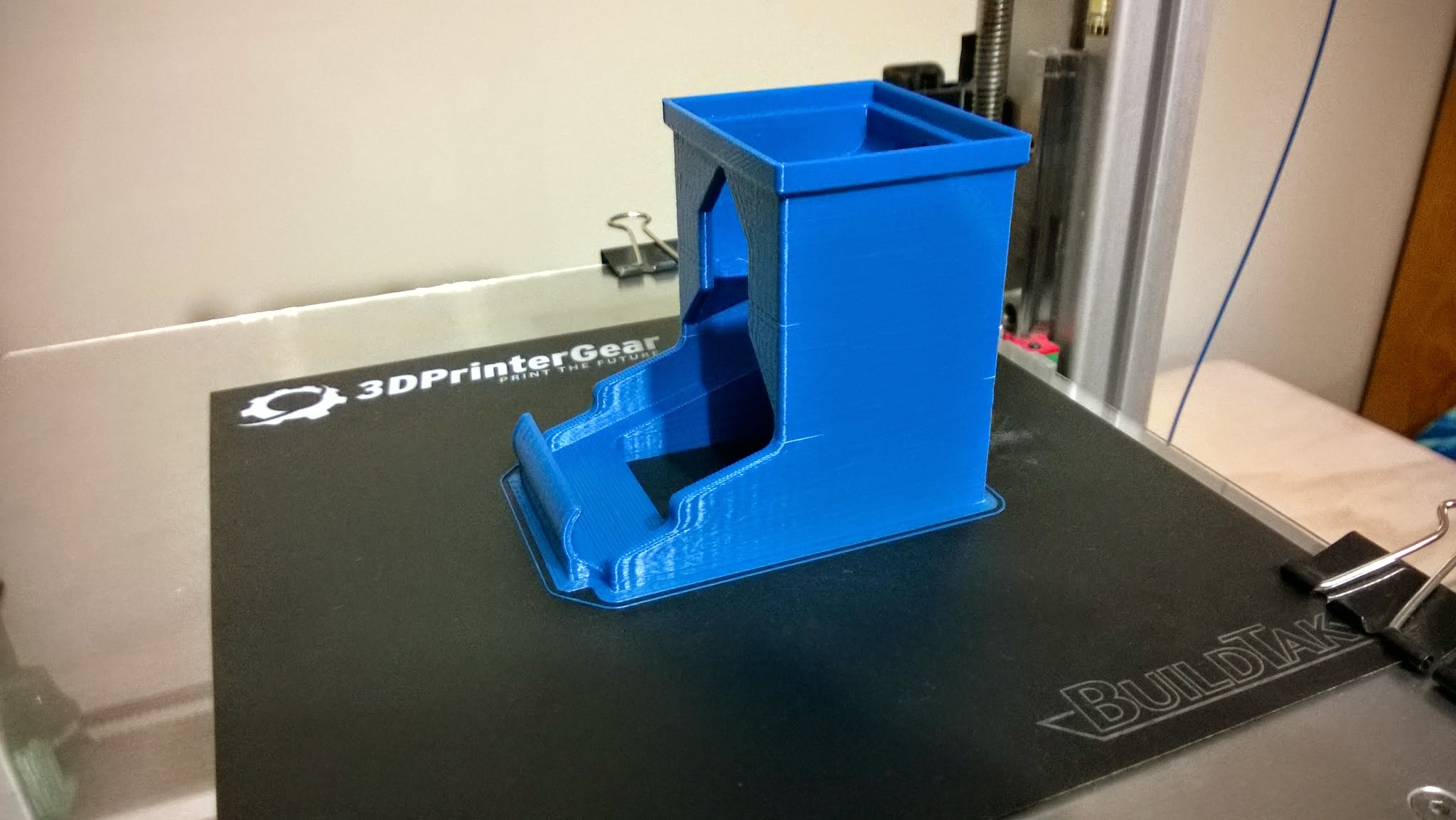

BuildTak with ABS I'm very impressed so far with how good BuildTak works with
BuildTak with ABS
I’m very impressed so far with how good BuildTak works with ABS. This was on a 80 degree bed too. The bed adhesion was so good there was some mid part shrinkage that caused a couple of stress fractures part way up the model.
In Slicer I have to add a bit of Z offest: -0.15mm
