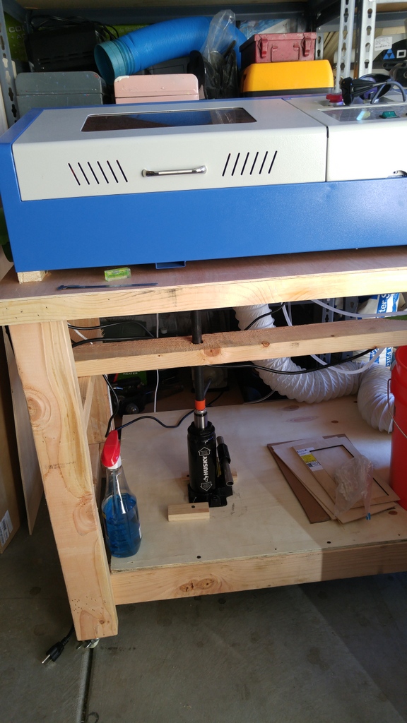

Built custom bed lift.  Bolted machine to table to keep it from moving,
Built custom bed lift. Bolted machine to table to keep it from moving, cut hole in bottom of machine and table, attached 12 inch 1/2 inch pipe with flange on bottom and inset screws on top, added support 2x4 below to keep it lined up and am using small hydraulic jack to raise/lower bed. So far it works great, total cost was about 40$ from home depot.
Note, had to install the pipe off center because of that support bar on the bottom, but it still came in very level and sturdy.
Very clever
nice idea, do you have a video of it in use?
Does it keep level when raising?
Where did you find your honeycomb metal for you bed ?
@Robert_Selvey http://www.lightobject.com/300X200-Honeycomb-Fit-K40-machine-P705.aspx
