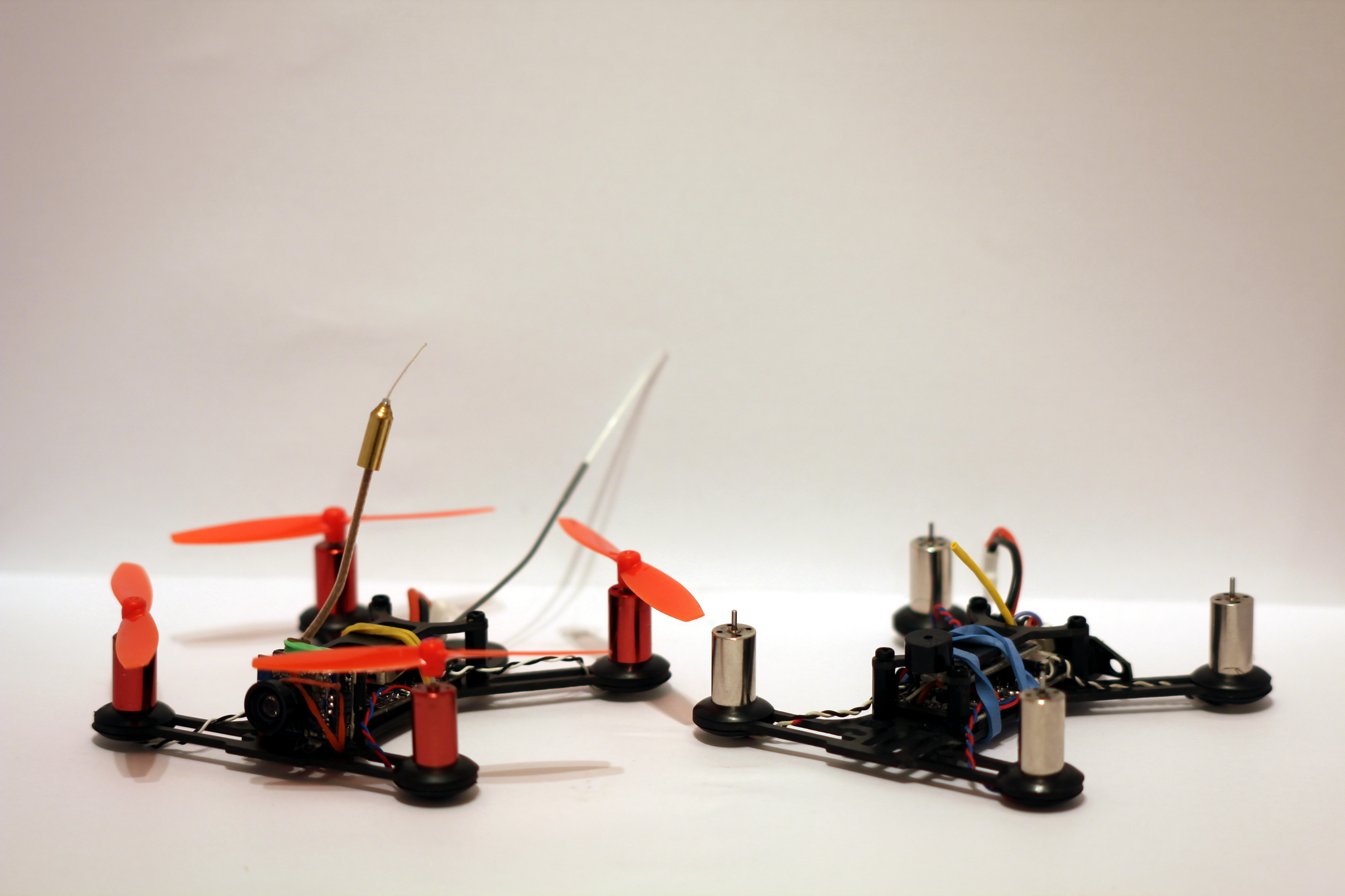

Built my first micro after figuring out I almost had enough spares to put together a second QX95. Modified the fragile CP antenna and fitted red racerstar motors. The original will go to my bro. Happy birthday @Daniel_Climent
That’s awesome! Love the red theme!
Are those the 820 motors?
Yes, they are Racerstar 8520. I was using my spare QX95 frame, so I was locked in. I installed Betaflight on the f3 fc, are you running Cleanflight on yours?
Yeah I’m running cleanflight. With the 820’s I bet that thing is fast!

I’m using it as an indoor flyer, so yes, it’s fast. Too fast for me!
How much does it weigh? Mine weighs a little over 50g and I’m using 720’s but mines pretty fast so yours must be crazy!
I’m at 57g with a 25c 750mah battery and 40g without.
Wow I’m kinda surprised by that. We are a lot closer in weight than I thought. How long is your flight time?
Ha! If i could keep the thing in the air long enough to figure that out I would be very satisfied.
