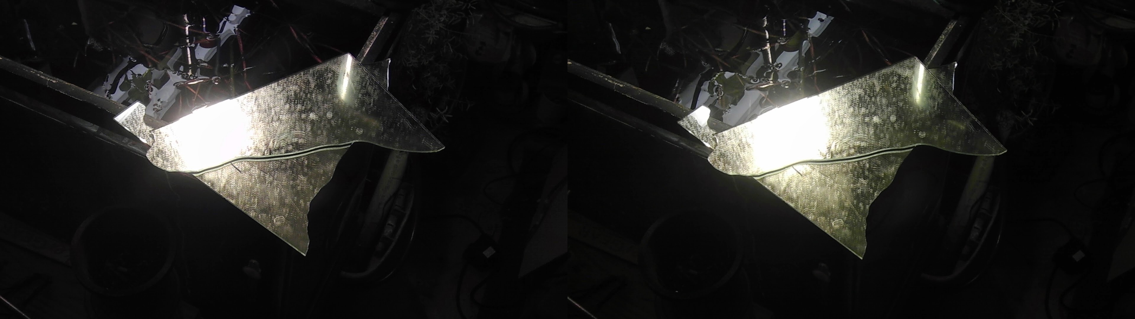

Busted! Again! The mirror print bed broke when I tried to heat the bed
Busted! Again!
The mirror print bed broke when I tried to heat the bed up to ABS temps. It looks like a 2nd temp sensor is just a touch high and created a stress point. PLA temps didn’t cause any problems with it.
One thing I noticed is when I used just the shard of mirror, the temperature quickly climbed that last 10 degrees. The temperature sensor was no longer under the mirror. The mirror must be radiating heat faster than the plain PCB board? Anybody have any science on this?

You need to use tempered glass if you want to go to ABS temps I think.
If I edge the glass on a belt sander and remove the stress points under the glass I can temp cycle it more than once. I had a piece of window glass that I edged last me a hole roll of ABS. I broke it when I got rough with it peeling a PLA part off of blue tape on the glass.
I’ve got 1 more tile left that I am going to cut and edge. We shall see how long it will last.
I love this thin mirror for PLA. I may need to get something else for ABS. Time (and broken glass) will tell.
I have a piece of plain 3mm glass sitting on top of two heated beds and have never had any problems with cracking. I can even crank one up all the way and leave the other one totally cold - the only issue that arises then is that the glass heats up a bit unevenly.
@Thomas_Sanladerer I am thinking my glass would have survived if there wasn’t a high spot under it from a thermistor. It just couldn’t survive 2 stressors.
Borosilicate glass has a very low CTE and therefore is unlikely to crack due to temperature gradients. You can buy it from mcmaster or I know trinitly labs sells it too.
