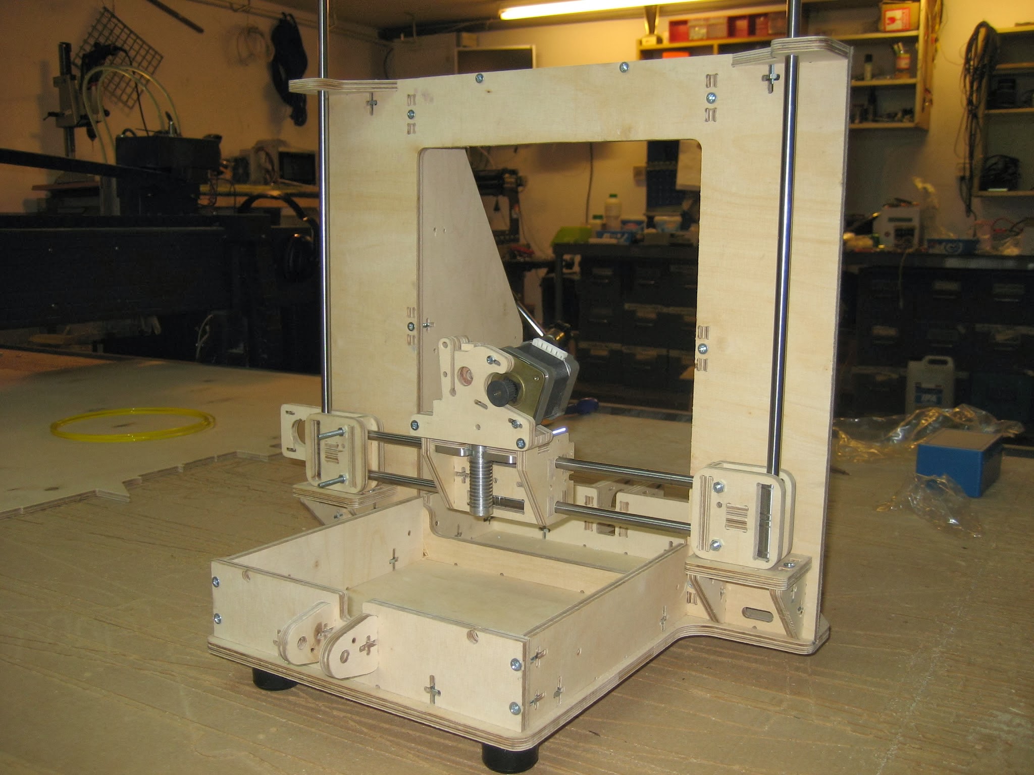

BYQ 3.0 first Polish fully plywood 3D printer
Looks good.
Are you going to share the design?
Yes, but first I have to workout some construction issues. Z-X axis works fine, but smooth rods are bending under low force put on extruder motor and that is my main source of worryâŚ

Itâs great to see an extruder design - in my case that was the only part I had to find printed, and you can imagine, a guy who builds a plywood frame is most often one who has no access to 3D printers. Plus, plywood should not be as heat-sensitive as ABS - so, great idea!
Btw, why do you have such wide walls on left and right side? They eat up space that could ne occupied by the bed, donât they?
Great shelf on top - a good start for a 1-motor Z axis⌠All in all a very neat kind of frame
Which smooth rods are bending? I find that I have to apply a lot of force to bend my 8-mm, but still one Z-rod is already arc-shaped, so I wonder whether I am having a similar kind of problemsâŚ
PS: word of advice: put more holes in the walls of the bottom box. Youâd want to attach stuff to them, and to put wires through, right? Youâd not want to pass all your wiring around the case would you? If I ever redo my frame, I will make much more holes in itâŚ
@Igor_Larine all walls are thicker because I reduce non construction relevant curves to cut it quicker. 5 frames from 8mm plywood are cut in 5h. On back are hidden PSU at right(if youâre looking at front), and electronic at left. âWingsâ are longer to hide whole pcb and connectors. I planned to make arcilic hoods with fans for cooling pcb, but I have changed plans. Now Iâm focused on maximal reduction of printed parts. Extruder is based on yegah extruder.
X smooth rods are bending. I thing that it is caused by small distance between rods in original design there is 45mm space in my 31.5mm. More over weight of extruder in i3 is tacked between X rods. I have to sleep overnight with this issues and figure out how to improve this design. Maybe some advices?
btw. That is my third iteration of my idea about Prusa i3;)
Nice made @Pawel_Dobrowolski

X rods - in my case the distance between then is 37.3 and I have had no problems with them bending. I mean, the X motor must apply a realy lot of force perpendicular to the rodâs center in order to bend it even slightly, right? I have recently managed to make mine quite parallel - 37.1 to 37.3 from left to right, but before the gap between them was 37.2-38.5 and I can tell you it did not really interfere with the movement or anything. Could there be something wrong with your linear bearings? Thatâs the only thing that comes to mind - LM8UUs are either not aligned and try to bite intoo the rod while moving, or maybe something wrong with the inner bearing cartridges. As for the rods - are they straight to begin with?
Btw, what is the bed size? Hard to guess, but if you say you hide a PSU behind one of the pillars it must be a largish frame after allâŚ
By 31.5mm I meant distance between centers of rods. Here you have more-less how ATX PSU is hidden: https://plus.google.com/u/0/photos?pid=5945417200368913858&oid=114419856911824933162

All I could come up with is just using calipers and sticking them between rods, more or less vertically⌠You can calculate the rest but thatâs already not measured but calculated values⌠Anyway, what kind of rods are you using? It would be interesting to see a video of them bending - maybe I experience something like this but not notice it.

I have chosen this particular design because I have got less space on the desk, so the more I can stack vertically the better - PSU is inside the lower box in my case, and only controller is behind the wing. Would love to stick the controller into the box as well, for it to sit horizontally - less worry for me that the radiators will drop off.
Btw, another question about the extruder - isnât the motor a bit too deep in all the layers of plywood? What are you going to use as gears and how will they interconnect? Or are you going to use a small-length circular belt, like the YRUDS/yegahC? That would make it necessary to have at least one printed part - that big gear on the hobbed bolt, right?
Smoothen rods are hardened special for linear bearings.
Iâve measured it at drawing in CAD.
This extruder is based at http://www.thingiverse.com/thing:53965
