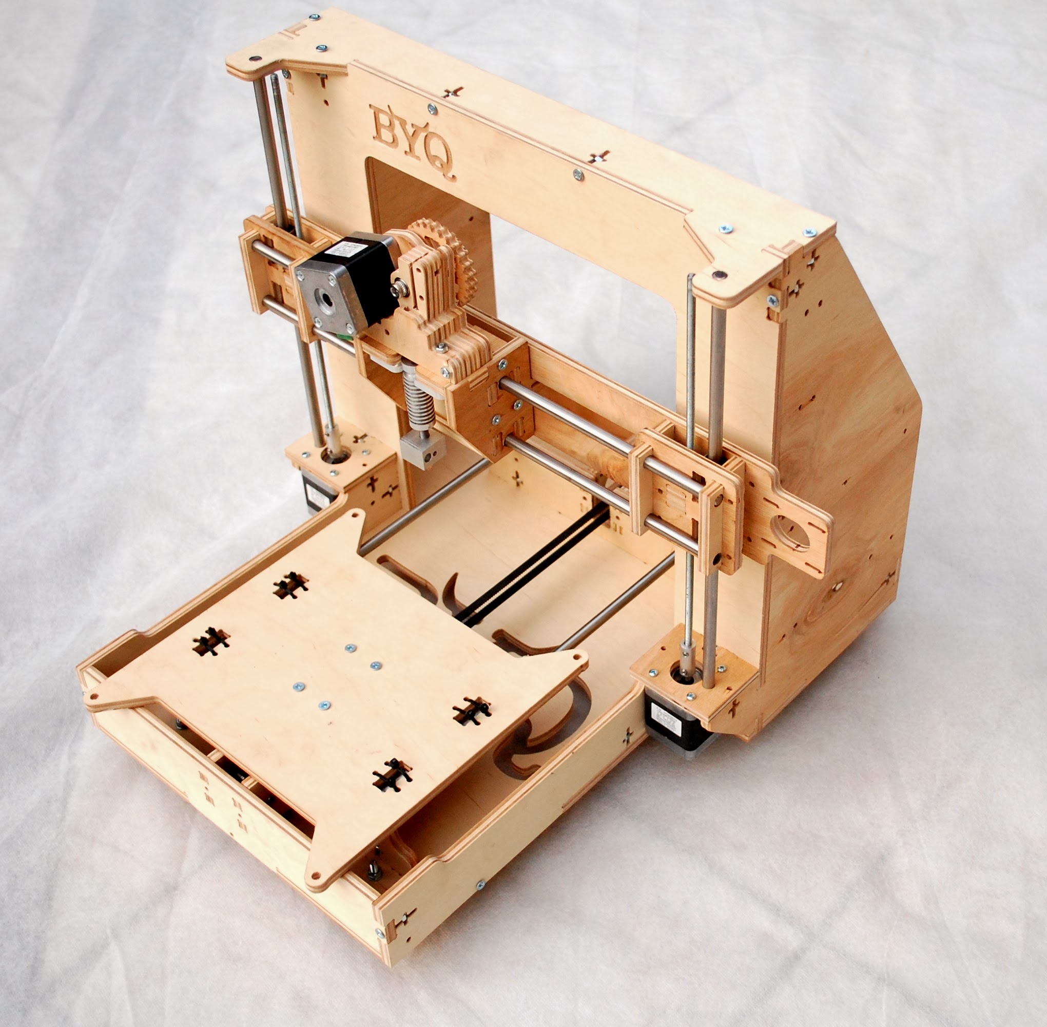

BYQ 3d printer is finally finished and ready for production.
BYQ 3d printer is finally finished and ready for production. YEAH!
I like the design. Could easily convert that in a PCB CNC. How much and where are you selling these?
I’m afraid that converting it into pcb cnc would be hard, but not impossible :slight_smile: Currently I’m selling it at my polish shop for 95Euro plus shipping. Moreover you can download dxf from girhub: https://github.com/syntetyczny/byq if you want cut it by yourself.
plans were published at g+ 3d printing group. https://github.com/syntetyczny/byq here you can download it. My shop is at http://www.sklep.pjd-automatyka.pl
What is the build envelope? 200 mm each direction?
150 x 200 x 160
With the 2 stepper design for the Z axis, there is no risk that the 2 stepper will not be in sync ?
On no I guess 1 stepper is for the Z and the other for the X right ?
Well done!
@Andre_Courchesne1 it’s a 2-stepper design, you are right. Plenty of printer designs use 2 steppers on Z axis, and as far as I have been able to find out it is considered to be better - for sync purposes as well as others - to have these two instead of one motor and a set of belts and pulleys relaying its torque to the two sides of the printer.

@Pawel_Dobrowolski I am sure to build one of your design at some future point, and wanted to ask - what do you think about extending the build envelope on Y axis? To 400 - 500 mm, in order to be able to print long items (which I find often necessary but impossible). How hard could that be?
@Andre_Courchesne1 I know many industrial heavy duty NC machines which has 2 motors at Z axis and there is no problem at any point. Secret is keeping geometry, that is why BYQ has straighten X axis.
@Igor_Larine it is not impossible, but in such variant I would you recommend bigger smooth rods at Y axis. Rest is similar.

It is hard to tell from this photo, but it doesn’t look like there are convenient places to run wires. I would love to see a photo of it all wired up. Printers become rats nests so quickly.
there are is a lot of space for that look at the back wall. It is outside in difference of standard prusa i3 or graber. I did it for hiding all wires in side that is why there is so many holes…
What plywood do you recommend for this design?
waterproof 8mm I/II
@Pawel_Dobrowolski I’m trying to find a supplier in the US (DC area). I’m new to this business with plywood, so I’m only guessing that marine plywood would be right.
How about I/II: is it a grade?
It is quality of top and bottom layer. I have to update drawings of printer so please wait day or two for update:)
