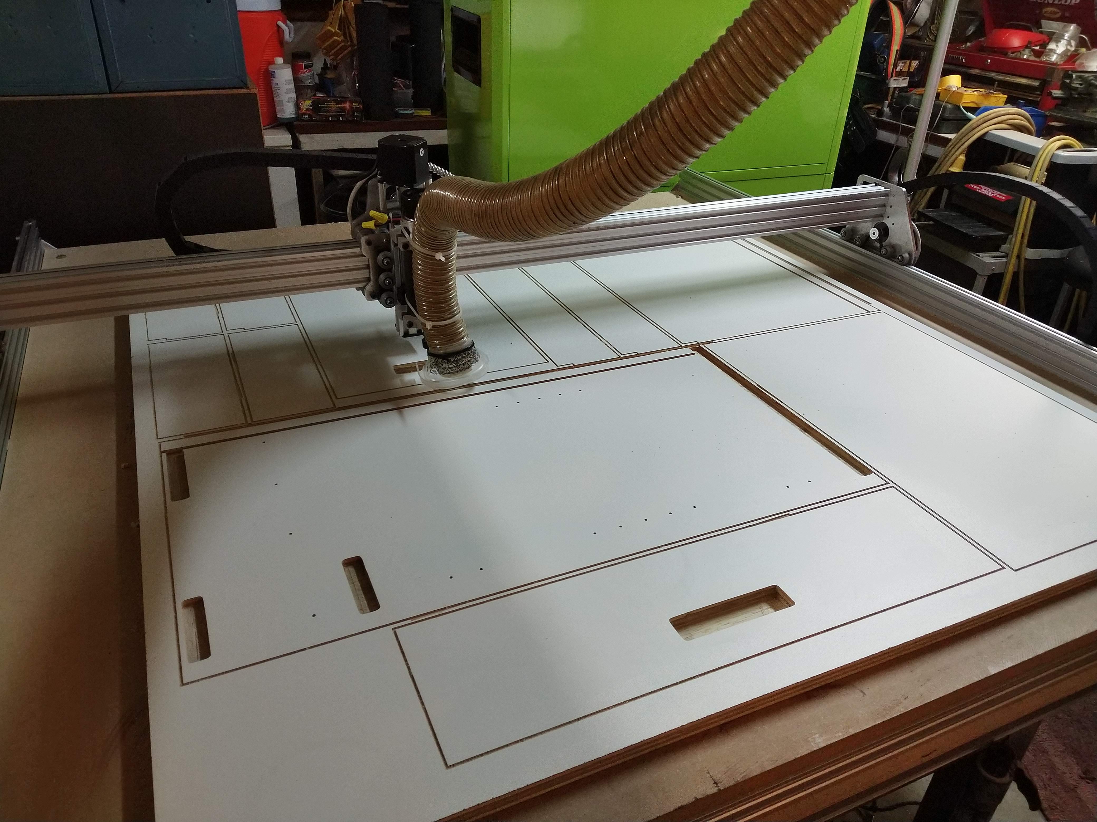

Cabinet parts! I had to give up on having the router cut everything out. Now she just traces the outlines for me. Less opportunity for failure.
Can I ask what problems you had using your CNC to actually cut the part out instead of just drawing lines?
