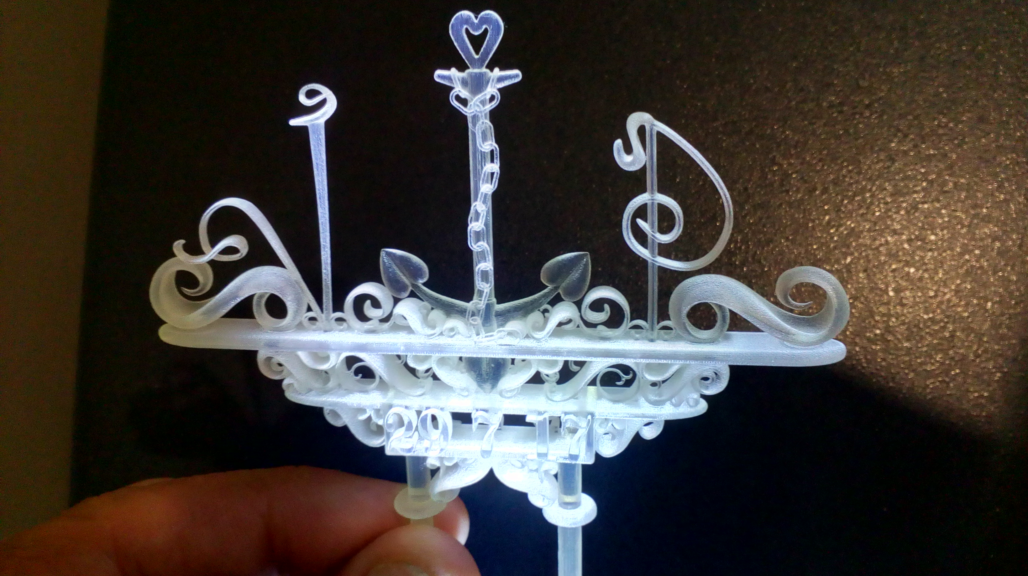

Cake topper, Printed on a 350 v Objet printer in 720 Semi Transparent.
Cake topper, Printed on a 350 v Objet printer in 720 Semi Transparent. Turned out well!!

That’s impressive. How are you printing without using supports?

Are you sure the resin is food safe?
@Kevin_Danger_Powers Hi Kevin, The piece was printed flat and there was support, in the form of a soft washable gel.
@Adam_Steinmark Hi Adam, the piece has legs which push into the cake, these were dipped in hot melted wax.
