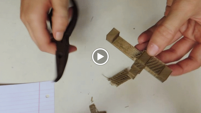

Calibrating my BotMaker: Stringing of the bowden extruder - check 40mm long brigde -
40mm long brigde - check
Support material - check
Blobs on the perimeters - not Check!!for the love of god they don´t go away!!
