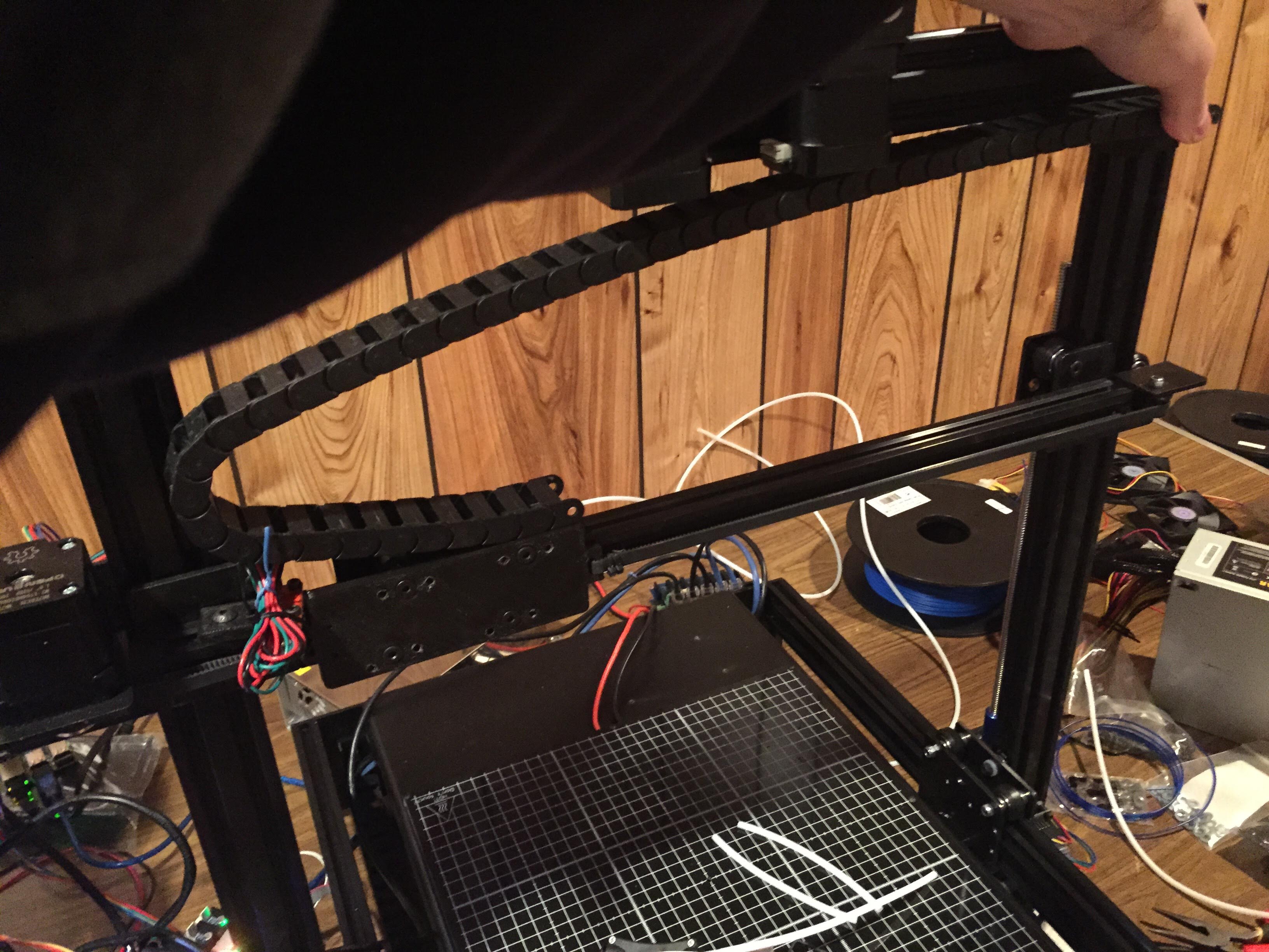

I’ve used cable chain in that manner before on other projects. So long as you have the geometry correct it should work.
Make sure you have enough chain to reach max x and max z without stretching, min x and min z without binding/crushing, and finally that both axes are in the same plane. …then you should be good.

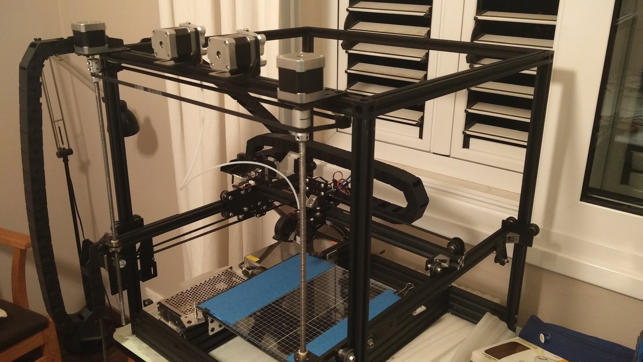

This is for I did mine
Works in 3 axis if you would wish to
