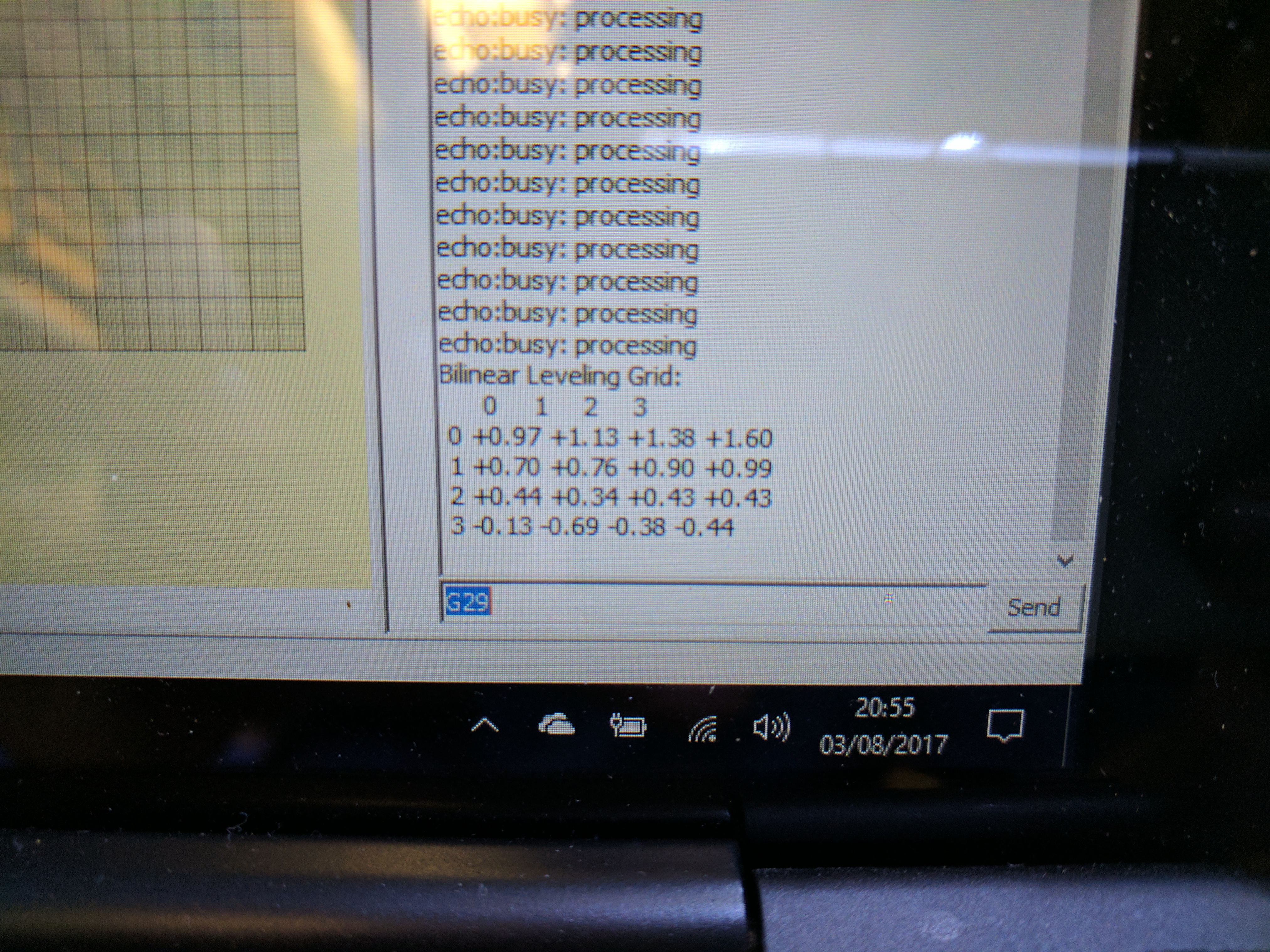

Can anybody tell me why I've started getting negative results from my auto levelling?
Can anybody tell me why I’ve started getting negative results from my auto levelling? Out of the blue the nozzle is being rammed into the bed on the back four points. I haven’t touched the firmware since setting it up the other day.

I’ve only just started it when I got this result, hot end and bed are cold but I get the same when it is up to temp. I thought it might be the inductive sensor but it only does it at the back end. I will try and upload the firmware again tomorrow to see if that helps.
I ran M851 and it gave the correct z offset the ran G28 followed by G29. I was wondering if I had done something to the firmware but I doubt even I could make it do this.lol
