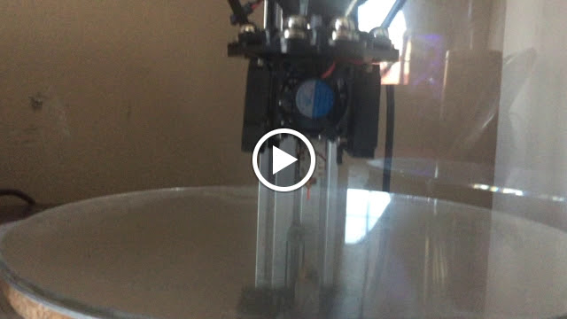

Can anyone give me pointers on how to trouble the issue in the video? basically movements to Y are slopped pretty badly (up). Here is what I checked so far,
Homing XYZ works good. Printer defaults .01 above bed
I can move the effector across the entire bed manually and it works without crashing into the bed (it is flat)
Checked belt tension and it is good
Checked all towers for proper level/height and it is good
Checked soft min and max endstops (all movement works) although it could be fine tuned
steps are tuned 100mm moves 100mm
This behavior is present when I print, or go to level the bed. I am well aware I messed something up, but can’t figure where to look next. Any help would be greatly appreciated! thanks
