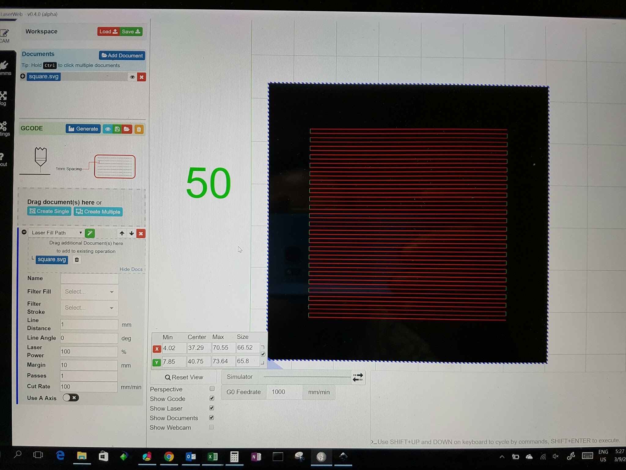

Can anyone please explain to me what the "Margin" value means and what is
Can anyone please explain to me what the “Margin” value means and what is it used for in the “Laser Fill Path” function?

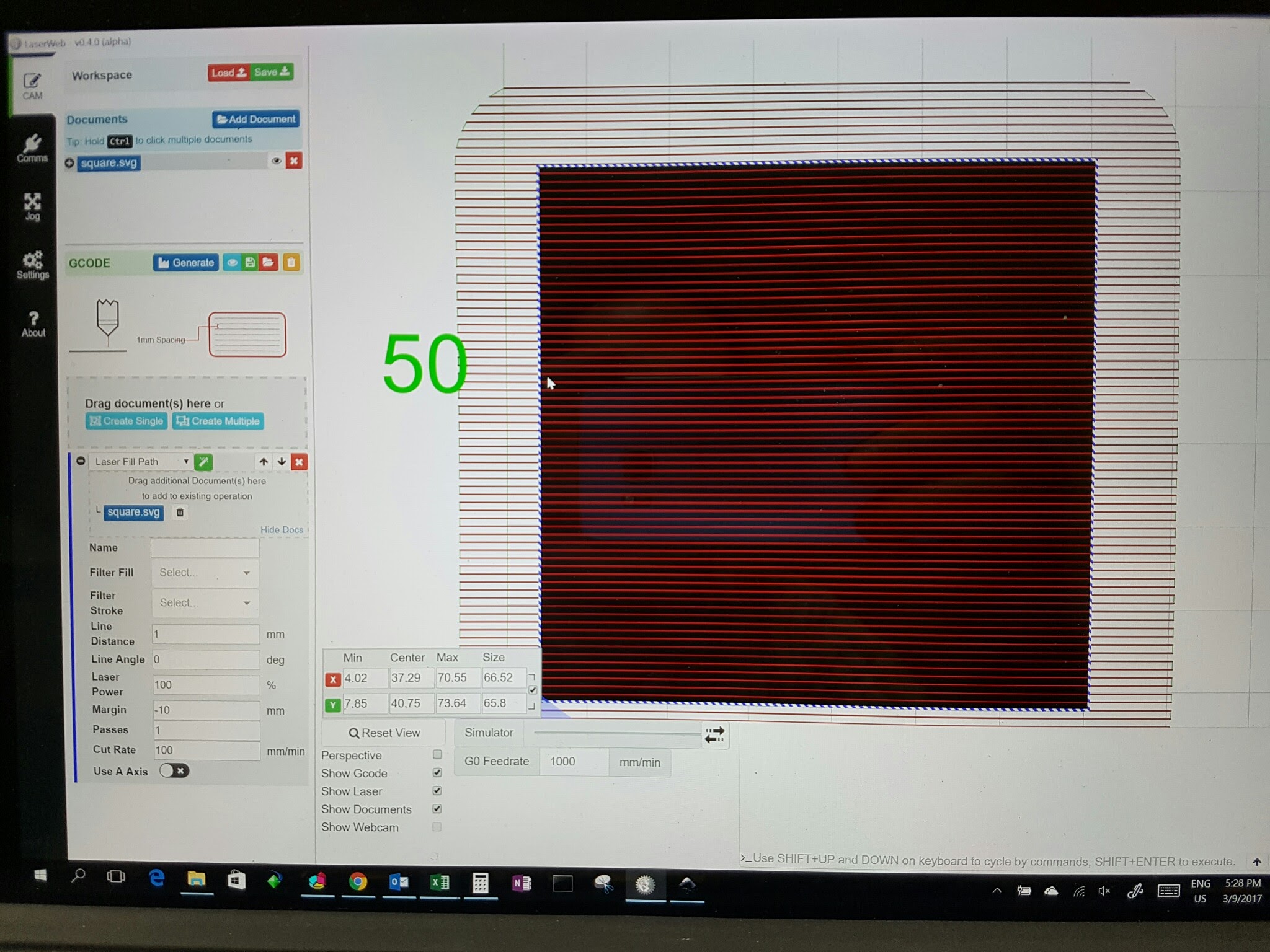

Will create kind of an offset. Can be negative or positive
Perfect, thank you very much
That’s interesting to note that negative margins create rounded corners. Might come in handy one day, maybe.
The same works on path with interesting effects also
