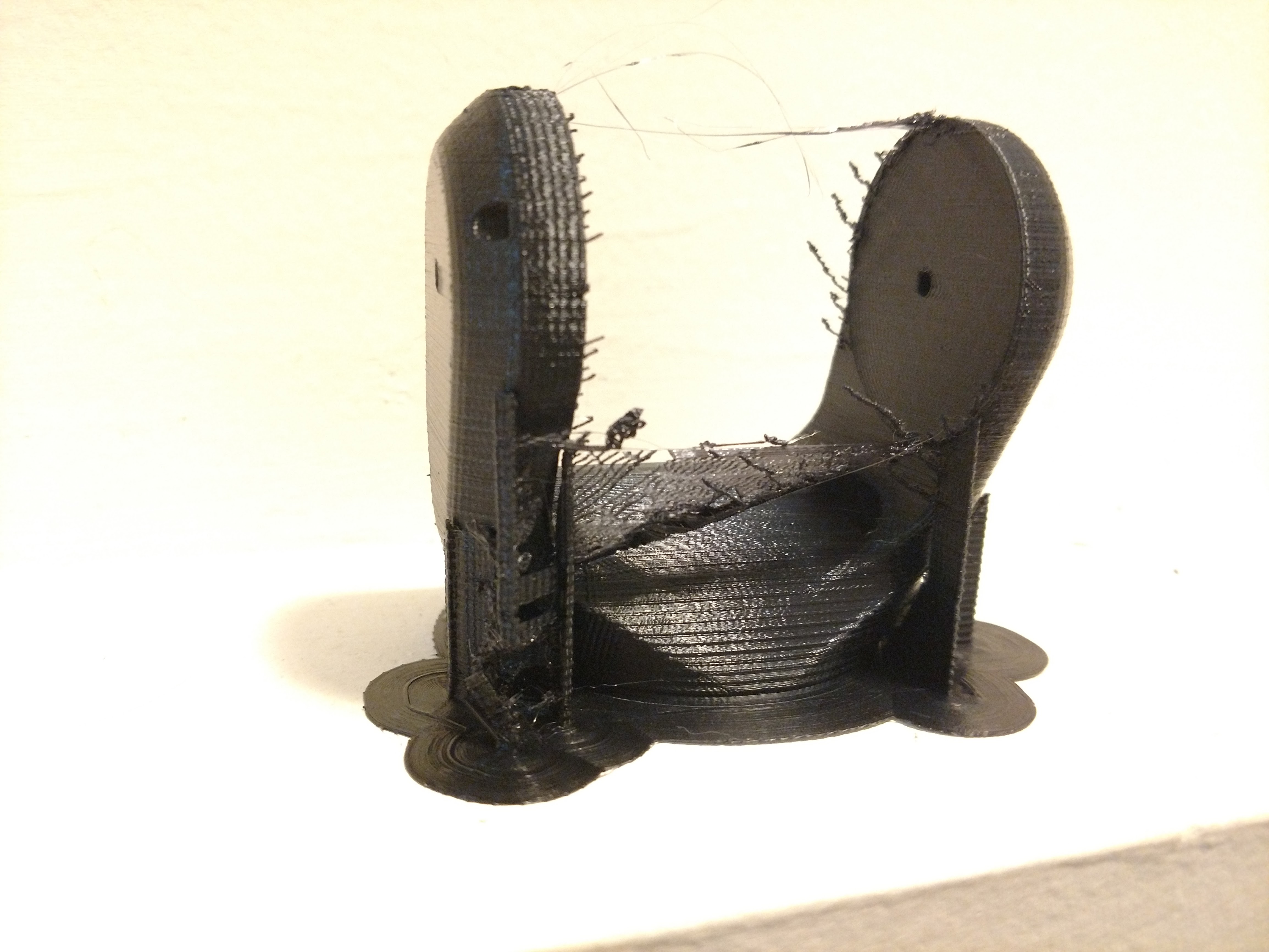

Can anyone put a finger on why this is happening?
Can anyone put a finger on why this is happening? The parts clean up just fine but the supports came out like this. Is this possibility because of the type of support? This seems like something that could easily be pointed out by someone that knows what they are doing. Lol.
I’d try faster transits and a little more retraction.
Basically this is the result of the retraction not causing the internal pressure of the hot end to be completely released. Set your slicer to travel a little bit longer over the printed part after retracting and then faster travel across the gap should also help.
@Jim_Christiansen I’m already extracting 4mm at 25mm/s. Should I do more? I seems like 4 is already kinda high.
@ThantiK do you happen to know what those settings are called? I’m using Cura.
It depends on your machine. I’m using a long Bowden tube and retract 6 mm. I’m​ using rather book numbers in my Marlin firmware for retract Accel.
The print quality at 5mm was like your pictures. 6 mm is so much cleaner
@Jim_Christiansen ok, I’ll try upping it to 5mm and then maybe 6 and see what happens.
Just a warning, if you retract too much into the cold zone, you risk clogging your nozzle or even the Hotend itself.
I managed to destroy a hexagon full metal Hotend due to trying to retract too much…
I was retracting 7mm with PETG.

@NathanielStenzel well I changed the retraction speed and distance just a little and my last print turned out great! The part even had some big gaps where retraction was necessary and there were very few, very thing strings across the part. I was quite surprised. No jams either. I might have found the sweet spot for this setting.
