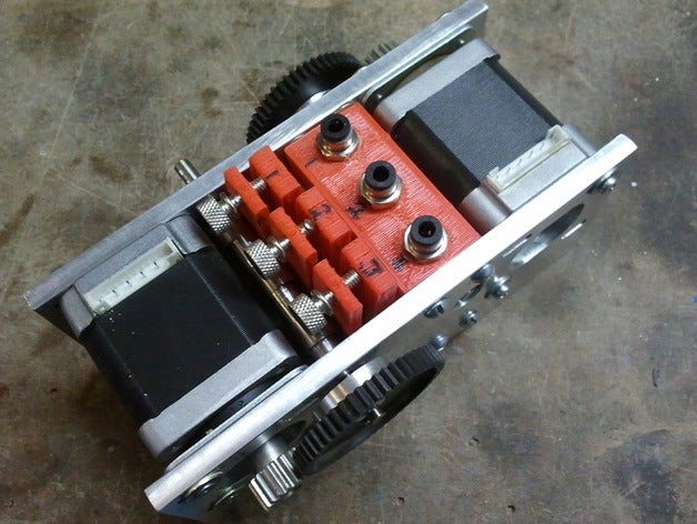

Ok, so on a vaguely related topic, is anyone aware of work on solutions that use only 1 motor to drive several filaments (1 filament at a time) with a servo/solenoid actuated selection mechanism? Seems inefficient to use 3 steppers and 3 drivers on a 3 nozzle rig when 2 are always going to be idle. I figure this would need changes to firmware to accommodate for this while using existing I/O on the electronics to drive servos/solenoids. Mechanically, I was thinking of a wades style extruder with 3 hobbed grooves in the bolt and 3 servo actuated idlers each aligned to a corresponding groove.
@Tim_Rastall there’s a project which uses 2 stepper motors to drive 3+ filament drivers. It uses a cam system to engage the idler.
It could practically be extended for any number of numbers of filaments if you absolutely wanted.
There’s a patent for using both sides of the same push wheel, with clamping idlers on each side. This way, turning the motor one way extruder one filament, and reversing which of the idlers is under pressure allows the motor to push the other filament when reversed.
I believe it’s Dimension that holds that one. The MakerBot Mk7 or up wouldn’t be hard to convert to that.
@ThantiK Huh, I had a cam actuated version option in my head too. This one looks like a winner.
