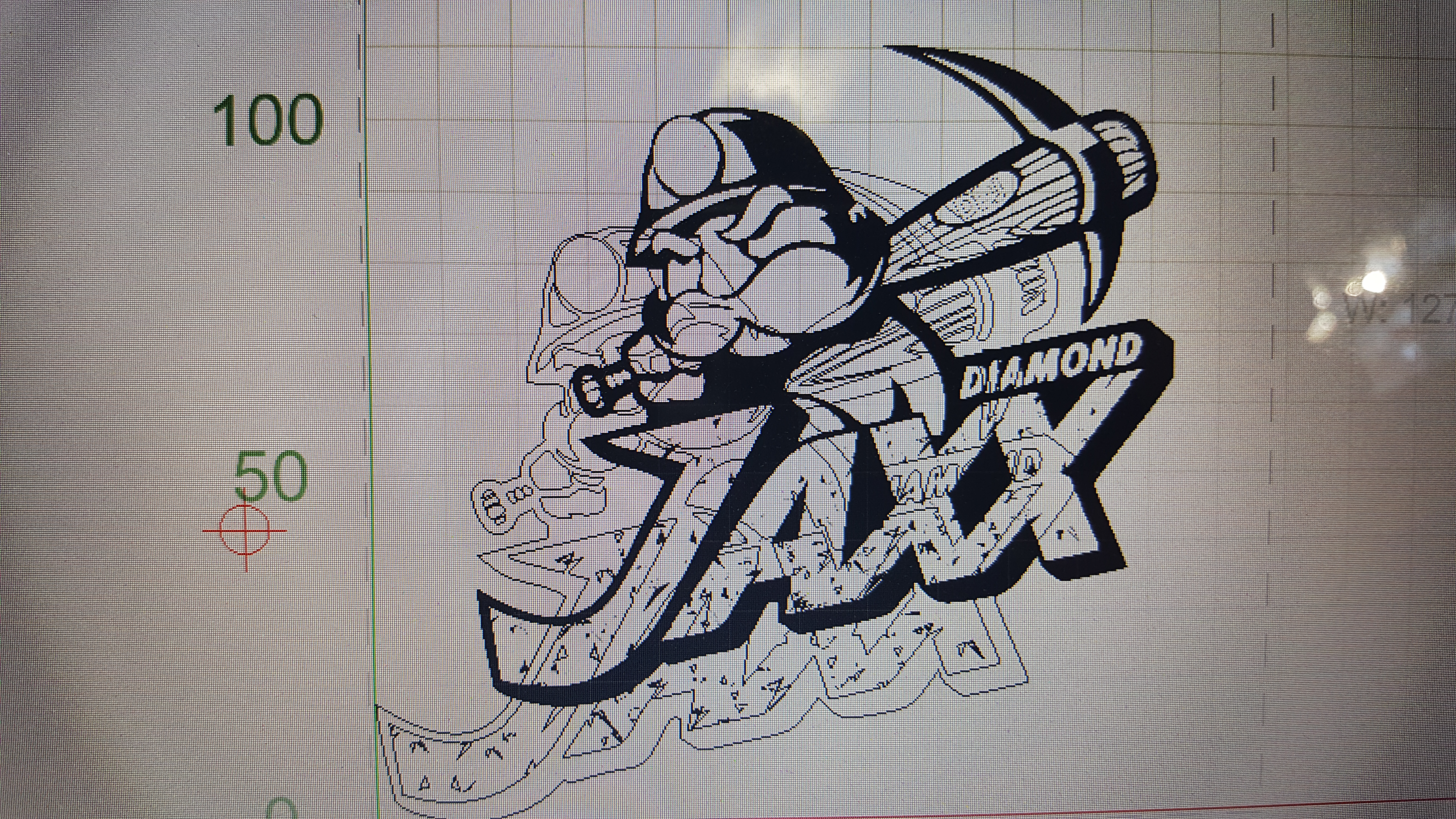

Can anyone tell me why the trace to vector offsets like this?
Because it’s removing the background, maybe do the image as png
Thanks @Ariel_Yahni_UniKpty ​. That means start with a png?
@Chuck_Comito ​ yeah, get that image as a PNG with no background that way http://you.get the corner into the 0,0 mark as the trace. Or just move the trace. The best option is to do all that in inskcape or AI. Let me know
