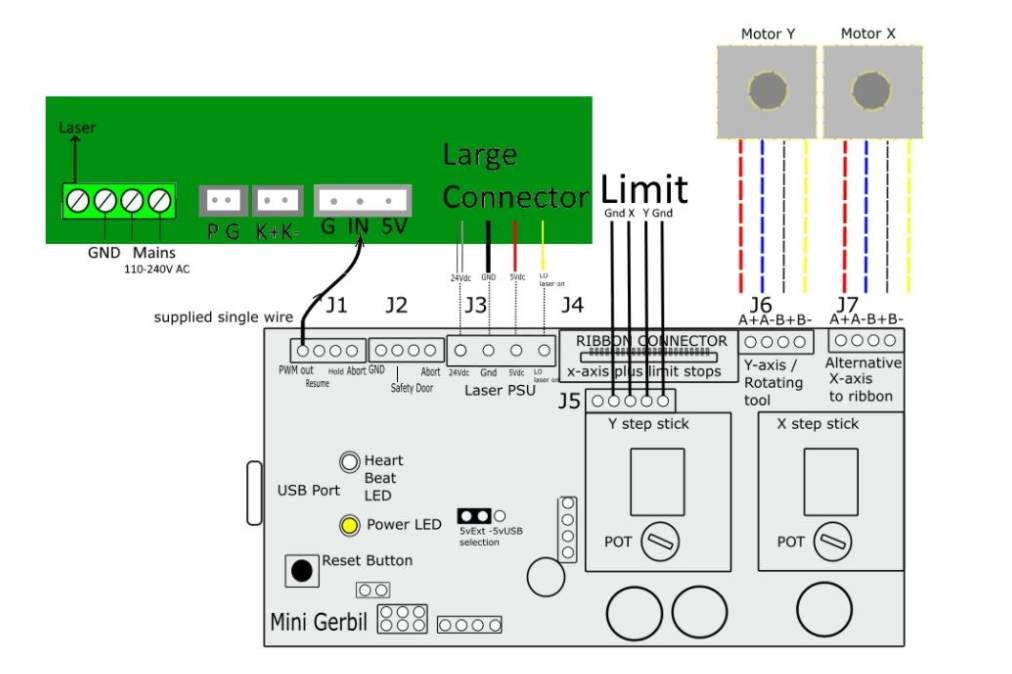

Smoothieware, Grbl_ESP32, and Mini Gerbil’s Grbl fork can/do use two pins.

This grbl board is connected to the lps the same way as the Ruida.
The designated use of the IN for an lps is to control power. If you put a analog or digital signal there it is eventually the pwm that actually turns the tube on and off to produce an apparent difference in power.
However if the laser is not enabled to fire, nothing happens. When L on the lps is pulled low that enables the laser and it lases at whatever in going into the IN input. You are in effect turning on and off the pwm set at IN.

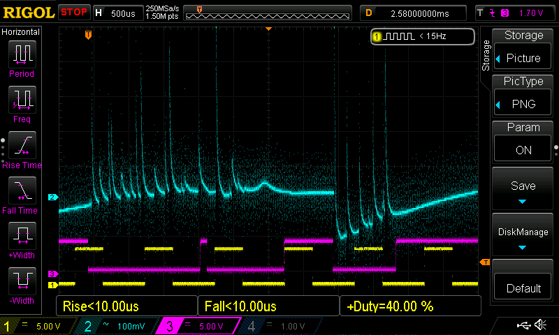

It’s not required to be a high frequency. Here is a screenshot of mine drawing a line of dithers with a 1mS period for the pwm (1kHz). Normally the Ruida has a 50uS period (20kHz). You can change it in the controller. Even the Arduino has a 1kHz pwm.
Blue is voltage across the mA meter. Purple is L (L-On1 Ruida) and is the trigger. The yellow is the pwm at 40% power.
Probably not what you expected… had me scratching my head a while…
The pot on a K40 doesn’t really control how much current your tube gets. The tube will draw whatever the lps can deliver… you have to adjust the lps to limit tube current. If you use 50% power, that means you tube lases at 100% power for 50% of the time…
