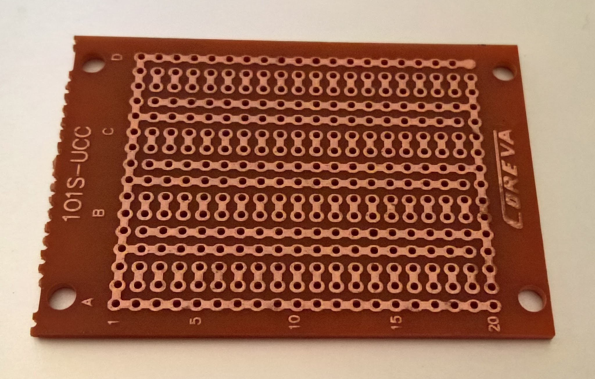

Can I cut a PCB with the K40? Anyone have any experience with this?
I’m working on my LaserCam mod today & need to use sections of this PCB for my LEDs & resistors.
No, you can’t. FR4 is really nasty stuff, and it will just blacken. It’s best to just score with a knife and snap anyways, if I recall correctly.
@ThantiK Thanks for that ThanktiK. I wasn’t aware. I will do as you suggested.
If you get FR2 (paper based), it’s easier to score a PCB. Unfortunately, I haven’t found anything that does copper… if you have a UV/Blue laser, you can etch photo-resist. If you paint black, you can use a K40 to get rid of the paint and then use an etchant to do the pcb.
But copper doesn’t want to be cut. It reflects more than it absorbs of the 10um CO2 wavelength, and even if yo got it to absorb (eg, Fiber Laser with 1um), by the time it absorbs it, it conducts the heat rapidly away…
There is toutorials on YouTube on scoring PCB check it out if you are unsure
Thanks @Thor_Johnson & @Alex_Krause .
I’ve managed to score it with a simple Stanley knife & a ruler then snapped it. Not super straight edge, but doesn’t really matter. It’s just to hold 1 led & 1 resistor (for each of the 2 that I made) to make it easier to mount them where I want them going.
But, I’ll keep in mind what you mentioned for future if I ever want to etch photo-resist. & yeah, YouTube is always a great resource. Thanks again.
