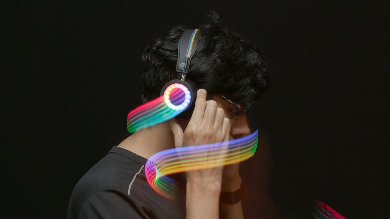

i am looking forward to make this but not the headphone. i want to control led strip via bluetooth like different animation. is it possible?
you can easily convert this to FASTLED
(you have to add /modify the BT-Setup routine from the Bluefruit and include Fastled.h instead of FastSPI_LED2.h )
